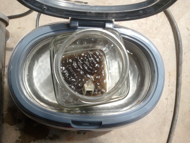

Here's one I did the other day - the ultrasonic bath is full of water, and the jar sittng in that holds methanol (and the injector).VX L67 Getrag wrote:Hey All,
Still playing with this & wondering what an ultrasonic bath does & how important it is to finish injector cleaning job off? There was a good youtube vid for this too.
Cheers VX L67 Getrag
The methanol was fresh before starting
I know the proper method of ultrasonic cleaning involves pumping cleaner through the injectors and pulsing them while in the bath, but this was just for giggles while I was killing time.

WOW, That is pretty cool, I think I might have to invest!
Was the injector reasonably externally clean before putting it in the bath?

Yep it was clean except for carbon around the tip - but that pic might be a bit misleading, as the combination of methanol and ultrasonic waves stripped the paint off the injector
I've found my cleaner to be more or less useless with water/detergent baths etc, but add something more agressive and it does wonders.

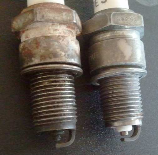

Here's a pair of old spark plugs that I fouled the other day - one has spent 3 minutes in the cleaner with a little citric acid, can you pick which one?

cool just what I need to clean fould spark plugs at the track

My little ultrasonic cleaner cost less than the 8 spark plugs I've cleaned in it this morning, so has paid for itself I reckon

With spark plugs & citric acid did you just have that direct in the bath, not like injector in methanol in glass?
Could you not put methanol direct in bowl as it could ignite?
