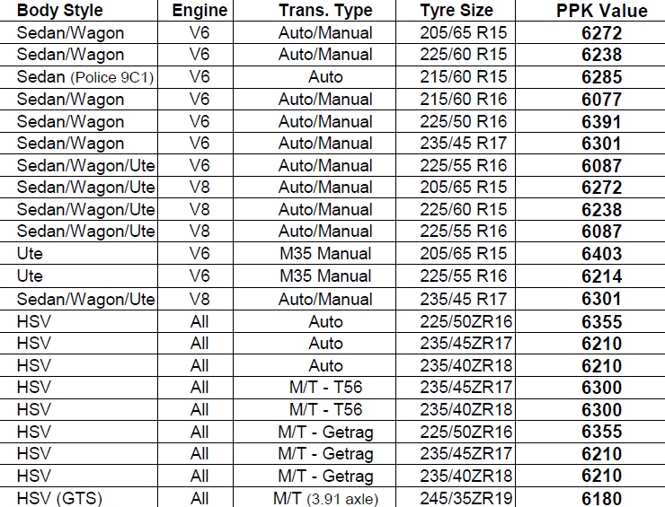

I was actually looking for info to show me detail about my BCM I stuffed up & came across this (attached Jpeg) it is purely for PPK value in dash clusters VT- VXs2 & poss more?
so that atleast shows the differences changed in dash value for each model/tyre/driveline but as referenced earlier the PPK value for PCM should be the same for all the models!
I'm going to log this problem child tomorrow & if the PCM has the right value & logging at original correct speed & then I'll data trace when exactly each gear change is happening & if it all looks right I have no idea what's causing the issue & will just change the PCM PPK value for it to eleviate the problem although it's not the correct way it will at least be global!
