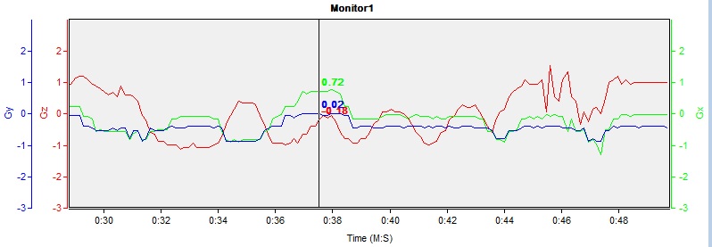

I've been re-visiting this project over the last couple of days because I'm hoping to actually have a use for it soon...
Logging to csv was never going to be much use, after a bit of poking around I worked out 95% of the XDL header and record structure so now it writes native TP logs instead.
The logging speed was still a bit slow, averaging about 4.5Hz compared to 8Hz with my laptop.
I was sure it was logging faster than that last time I was working on it, and eventually found the cause of the slowdown was the LCD driver. I'd made some changes to it a month or two ago to fix a timing glitch, and hadn't noticed it was slower.
Fixing that got the speed up to almost 6Hz, and changing the code to only update the screen every third message bumped the speed up to 8Hz. It also made the screen more readable, the numbers aren't just a blur now so double win
Next job was to add my 10 channel analogue input module and get it into the log stream. I dropped the resolution to 8 bits to keep it simple, and added some rough accelerometer calibration figures to the ADX: There's a bunch more sensors I'd like to add to the car, so the other analogue inputs will be put to good use before long...
Currently the lap marker trigger is a push button, but I want to come up with something better.
Options I'm going to look into are:
* GPS proximity to the start line,
* an IR transmitter on the pit wall (that's how most people do it), or
* some method of detecting the transponder pickup that's embedded in the track at the start/finish line. This would be the best option, but also the hardest to implement by a long way I think
