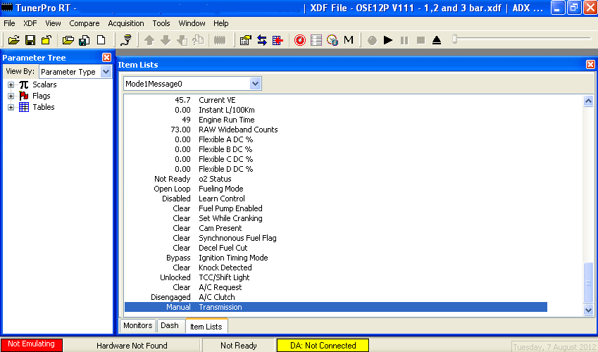

this is the stock 12 tune that came on the nvram
my next question is how do u tell the ecu that its auto ? motor wont start if its not in park or neutral but i couldnt see a flag to say manual or auto is there one ?
- Posts: 10111
Re: dave V6 ek holden
Have a look on the 'item lists' view when your logging. The very last line is Transmission. It'll say automatic or manual there. It defaults to manual (this screenshot is no car connected) but should say auto on yours when logging.

ok thanks would the playing back of a log give me the correct data or do i need to hook up to ecu ?
my log from last run show it as manual ?
