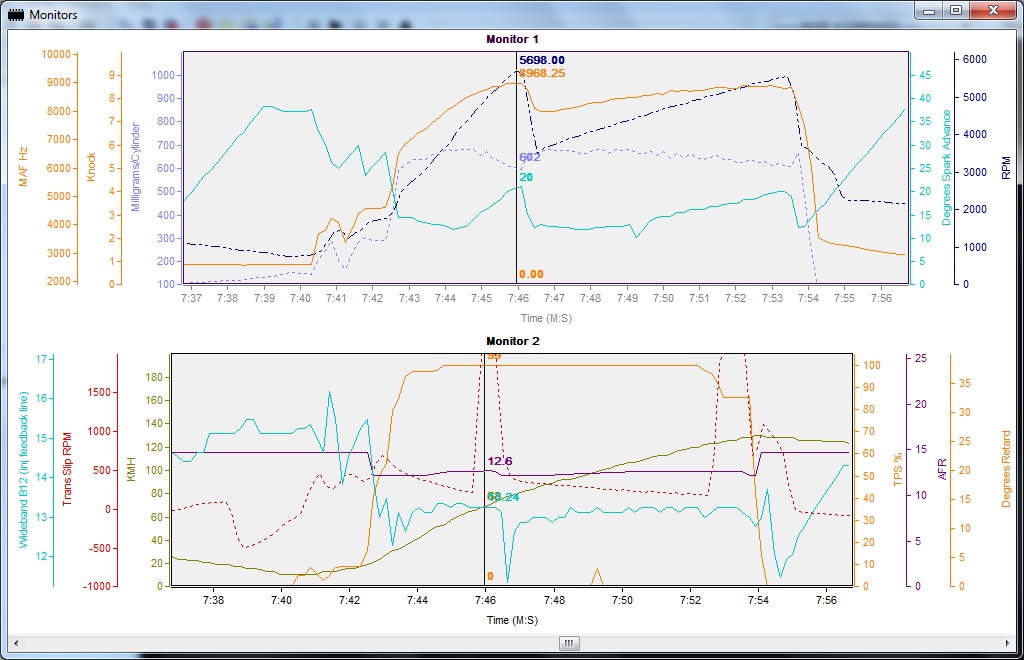

Re: Extended Factory Bins
Had a play on the bench today with VS V6 N/A, have added extended spark tables to high and low now, still same cylair as stock tables, but can atleast ramp spark up properly now, went for a drive to test and getting over 600cylair at redline! 9000hz MAF, slight increase, ramp it up a little more.
