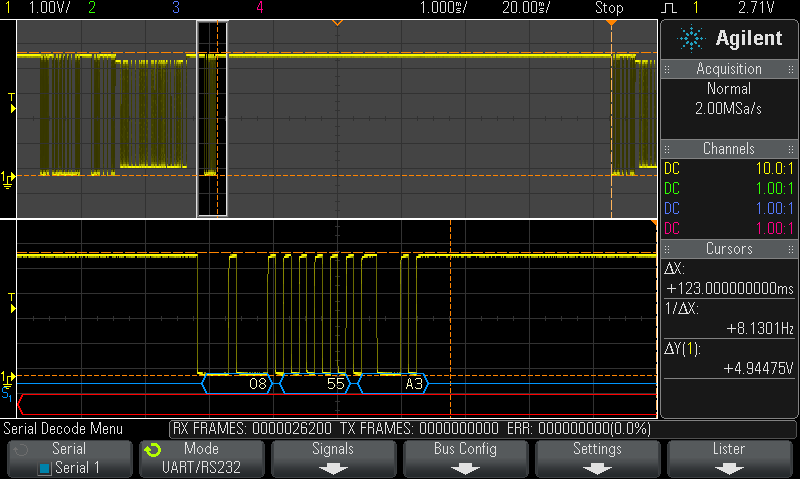

This is what the bus of a VT looks like on a scope, it repeats over and over (its all BCM initiated with the replies coming from all the devices when they are addressed). You can see the ~123ms free bus time that you should be aiming for when initiating comms and silencing the BCM...
And this shows a zoomed in section, heartbeat is the last thing before the free time...
Re: ALDL logger VB10
and that my friends is the delco matrix :P

Ahahahah, wow! Now that was interesting to see! Looks nice and organised when viewing by the scope.
