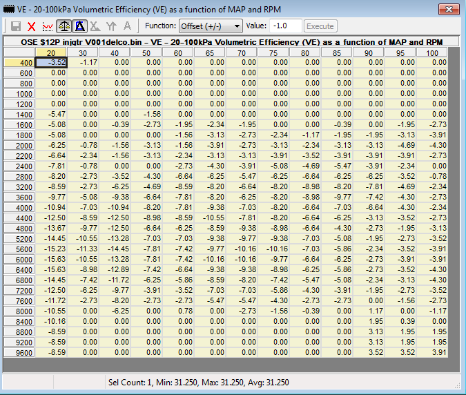

Since ive been all graphical in this thread, i'll stick with it so anyone whos trying to get a picture in their head how and how far to change the VE can get an idea. Here are delcowizzids suggested VE changes, as difference from the previous bin and to show the shape.
Im keen to see another log now :thumbup:

So that graph essentially shows how much more fuel has been put in the table compared to the last Bin?
ie. a minus number in a cell mean you have added that much?
Posts: 9004
Re: First fire up using Rt
Yes, changes in those cells. Im not sure why TP is saying minus. the values look correct, but they are increases in VE. I dont think im doing it backwards, i'll try and find out more. You can use the difference tool (the scales) without compare data and see the values in delcowizzids VE are larger. Compare->Load Compare bins->bin1->browse->pick other tune. Open VE table, toggle compare (scales icon).
The shape of the VE tends to follow the efficiency of the cam, and the shape of the spark tends to follow the shape of the VE. I like the shape of delcowizzids VE a lot more for that reason.
