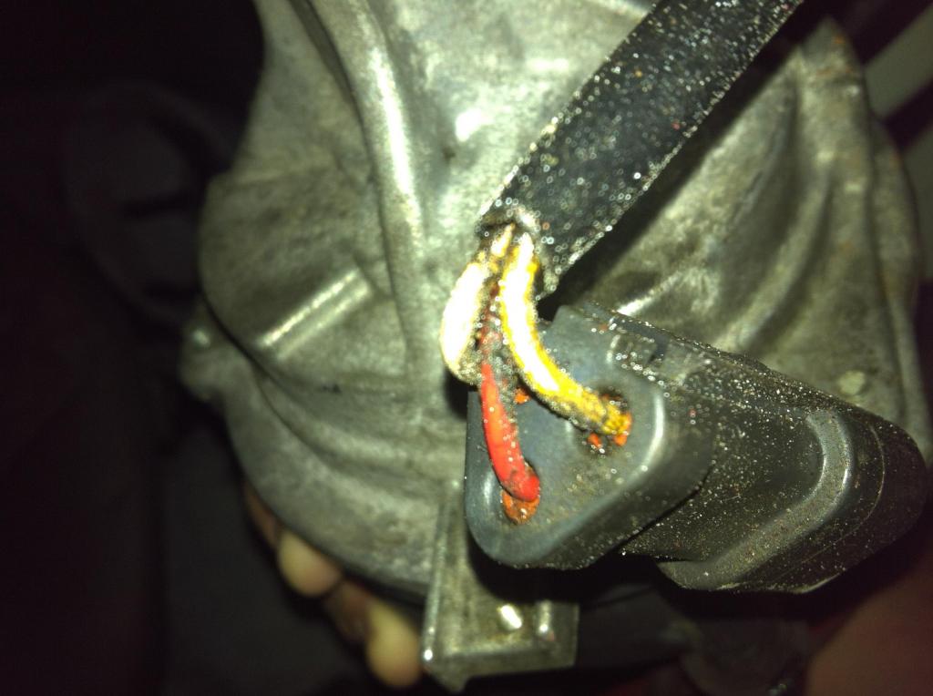

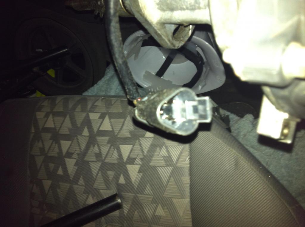

Im taking a guess that the 3fe uses a hall effect type sensor.
As the wiring diagram from the FSM Distributor has three wires that wire directly into the ECU. The ignition module
has two wires to the ECU but is wired to the coil, ground and tacho comb meter
Which is the speed sensor built into the dash cluster which reads off the speedo
cable.
After reading more about the speed sensor it produces 4 pulses per rotation of the speedo cable.
Apparently the ignition module and coil are pretty much brand new so im wondering
if its possible to use this?
Sorry about the bad pics I didnt get any time to pull anything apart as of yet.
If anyone can shed any light on the ignition setup and the best way to do it, it would
be appreciated.
Cheers

Re: 3F Carby Landcruiser Delco 808
Looking at the wiring diagram it has twin channel injection so figured it likely has a home/TDC signal. Found a pic of the 3FE dizzy innards. Could mod the 24 tooth to become a 6 tooth and use a camira module. Toyota loves reluctors.
http://i81.photobucket.com/albums/j212/ ... 0_1755.jpg
More pics .. http://forum.ih8mud.com/40-55-series-te ... -40-a.html
So do you think there is no chance of adapting the existing ignition module with the delco?
Not without a black box of magic smoke - would need some sort of interface for the reluctor signals, needs to handle cranking spark and then EST spark and then feed the existing module. A camira module is much easier. If you dont want to mod the dizzy my (still in development) custom module will work with a 24 + 2 dizzy.. https://pcmhacking.net/forums/view ... =10#p27226
