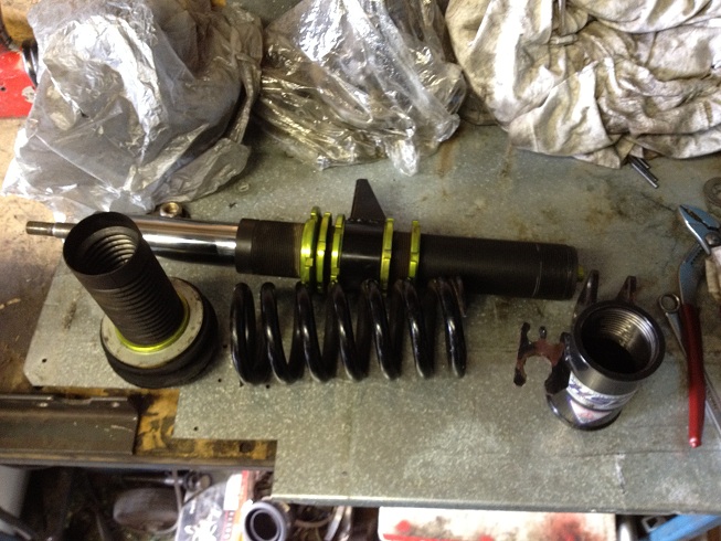

Next up,the suspension.
I didn't know which way i was going to go on this.
Originally i was saying to myself-------this is only a play-sprint car and i'll fit some stiff lower springs and a good set of shocks/struts and be done with it.
BUT we all know handling IS everything and you can have all the power in the world but if it dont turn properly - why bother.
A pair of HSD coil overs came up for sale for $550.00 and i ummmed and ahhhhhed about them for a week or so.
I finally convinced myself (which isnt hard)that even a basic set of front gas stuts and lowered coils was pushing $300 + so it was a no brainer
and have the luxury of adjustable dampening,ride height and spring tension.
HSD coil.jpg (157.97 KiB) Viewed 5929 times
HSD coil2.jpg (105.9 KiB) Viewed 5929 times
Fitted up easy and took a guess on the ride height.
On the ground it sits nice firm (no pic yet)
Next dilemma is the rear to sort out.....havent picked up a coilover for the rear as of yet.

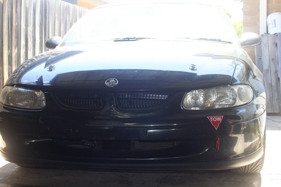

Next up i had to make up the front and rear tow points and add the stickers.
rear tow.jpg (156.92 KiB) Viewed 5851 times
front tow and pins.jpg (104.52 KiB) Viewed 5851 times

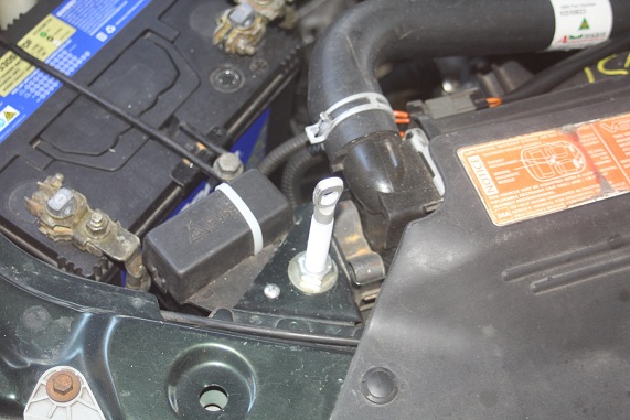

Also had to fit bonnet pins,luckily the VT onwards have these nifty triangle points on the rad support....ready made for racing :thumbup:
bonnet pin.jpg (125.55 KiB) Viewed 5851 times
