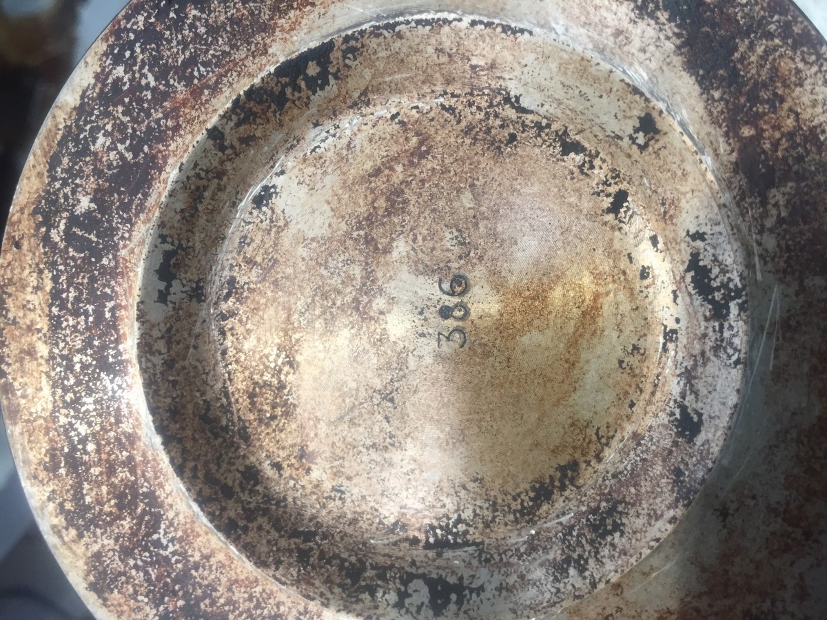

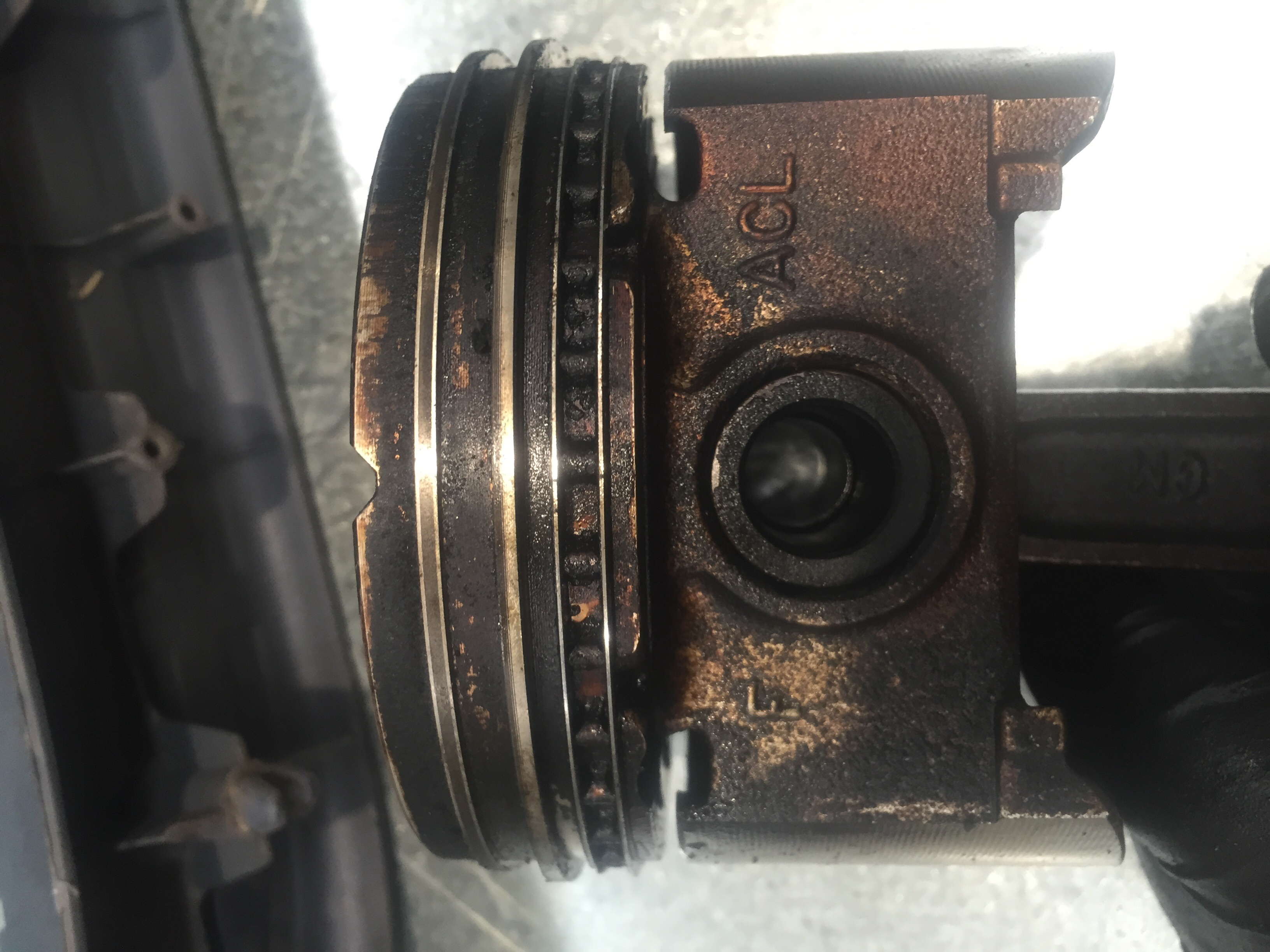

Got the 304 cleaned up and into the workshop and thought ok sump and timing cover just need a reseal pulled timing cover off found the timing chain had a bit to much slop and had already been upgraded to the rollmaster billet setup ok that's not to bad pulled the sump off and it was like sludge in there. there was bitumen on roads thinner so may as well check the bearings. Definitely worn but ok so may as well do a rebuild on it stripped it completely apart and found these in there
It's a vs sIII roller block from a hsv maloo
There was some numbers inside of the skirt but I forgot to get them also curious as to whether they are acl duralite series or race series Pistons looking at the skirt type near the oil rings would say duralite
Anyone know what acl part number they are they're standard size just need to know in case I decide to clean them up and run them again as I have done a bit of research and most people seem to say that acl Pistons run their own size rings. Bores only need a slight home just to remove a bit of glazing other than that you can still see the cross hatching and sizing is perfectIt's a vs sIII roller block from a hsv maloo

They are just the factory piston as acl was supplying the Pistons for the later 304 engines. You can tell cause they all had 386 stamped on them instead of the usual acl size part number ect and normally except the earlier had the Holden number 92060458 stamped up inside.
Re: Vp Wagon
Ah fair enough didn't know they also made the std Pistons for them did they do the bearings as well or just the Pistons as some of the bearings had acl think it was big ends and mains had only gm
