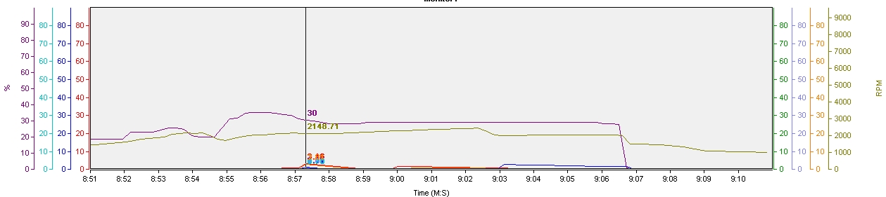

I've noticed when viewing the fuel consumption figures vs TPS Percentage. I've attached a pic.
Is this normal?
Posts: 10436
Re: Compatible Smaller Injector than Bosch 280 155 777
thats because the car is not moving so the l/100km will increase as you burn fuel without covering any distance.
