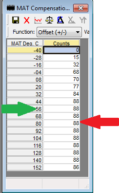

VL400 wrote:Roughly what would you expect the MAT to read?
well, it seems to be reading ambient temps accurately. the XDF item is where all my problems are. looking at the attached pic, to adjust the value at 56*C, i have to change the value at ~80*C. interpolation makes it tricky to adjust for the current ambient temperature. thats why I wanted to figure out the lookup table to determine if something isnt calculating right.
Re: Re-scaling MAT counts table $8D SAUJP
That looks to be possibly an error in the XDF, in factory code the table does not use MAT counts for its lookup so you cant have MAT linked the way it is for data tracing. Part of the lookup value is using the multiplier in "MAT Inverse Term Lookup Delta Mult. Vs. Airflow "
This is from the factory 8D code, maybe the SAUJP is different but from your findings I suspect not...

hmmm well i looked at the xdf item and really dont know what could be wrong. conversion is...1.000000 * X + 0.000000. could that be the problem?
You will need to ask the SAUJP hacker to be sure as I am not totally familar with the code base but if its the same as the factory disassembly I dont think your going to be able to use data tracing. The table does not use MAT (or MAT counts) as its lookup, so the bubble thats floating around is incorrect - as you have found.

understood, looks like ill need to figure out the lookup table and make some changes. so im thinking that I should display MAT as counts and compare to accurate temp guage and make the changes to the lookup table?
thanks for all your help!
