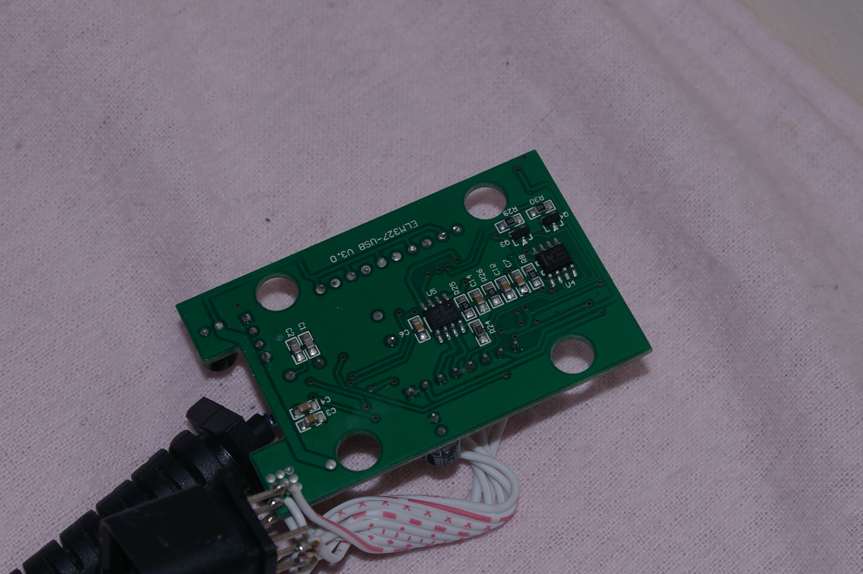

by delcowizzid
so my cable doesnt contain an elm chip LOL FTDI usb chip and pic microcontroller

delcowizzid wrote:so my cable doesnt contain an elm chip LOL FTDI usb chip and pic microcontroller
:lol: bahahaha... and theres the problem. That sounds like a aldl cable you got there maybe?

by delcowizzid
its an elm cable and circuit board says elm 327-usb v3.0 ebay special says multi protacol EOBD OBD CAN

delcowizzid wrote:its an elm cable and circuit board says elm 327-usb v3.0 ebay special says multi protacol EOBD OBD CAN
*Sigh* Its either a) not perfectly compliant with what a elm does eg respond to "ATZ"
or b) My app is still doing something wrong! lol
Im leaning towards my program doing something wrong since Charlescrown is having problem with a proper cable!
May I suggest running a free serialport monitor in background, see if the elm is even responding?! Just connect to the cable in the monitor then run my app.. see if the elm responds back (only do if you have nothing better to do! lol)
