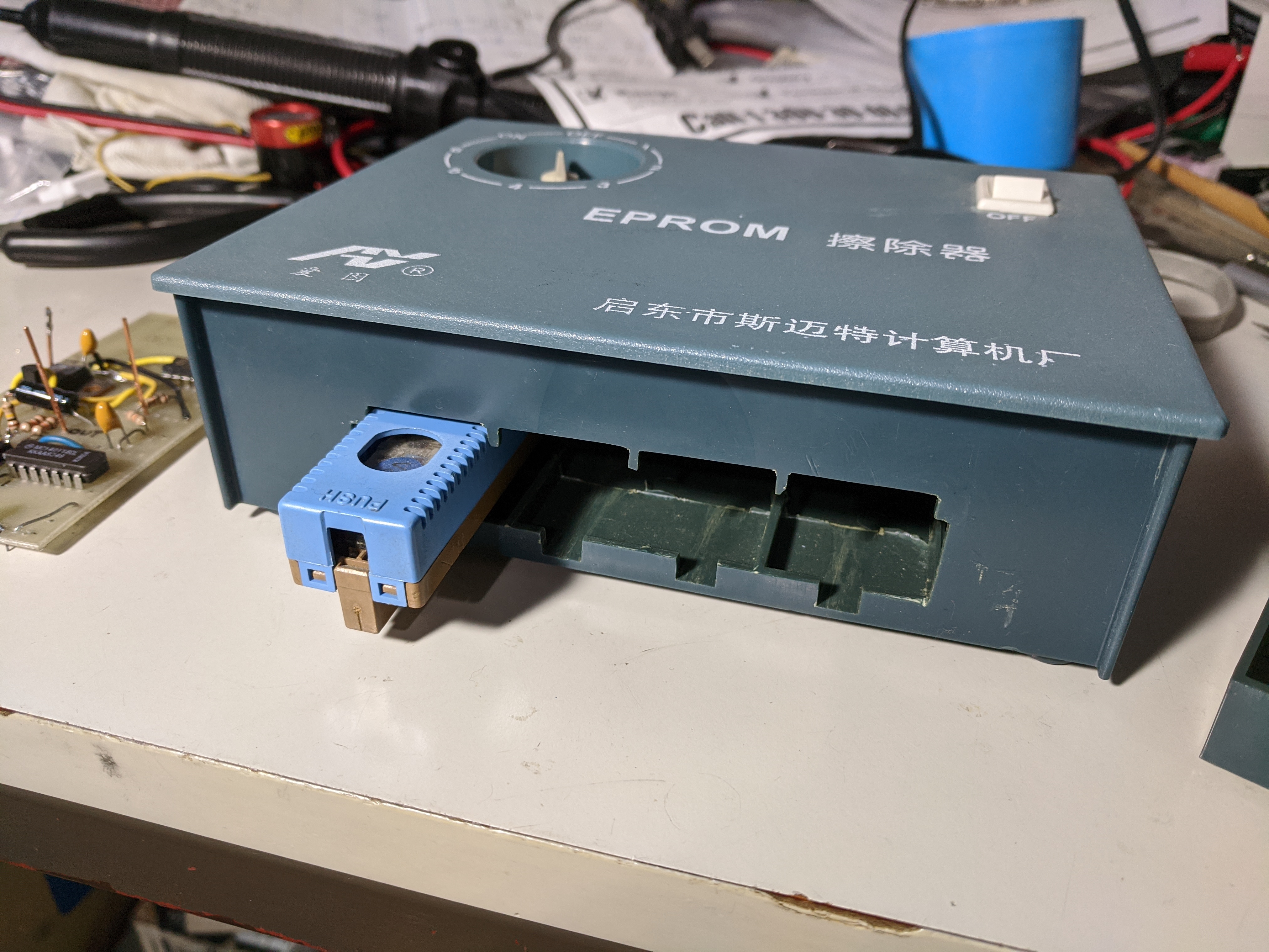

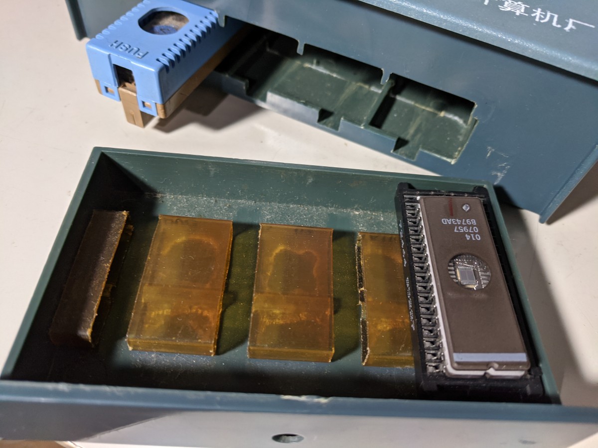

It depends on the eraser too. If you have a memcal and a standard blue eraser with a draw and your trying to fit the memcal in the hole with the draw out as best you can, the light doesnt enter straight and the whole chip will never erase. In this case you need to flip the chip over and expose it on the opposite side angle to get a good erase. You'll never get it all erased due to the poor angle of the UV light on the window. You might find big chunks done erase or you might find a few stubborn bits dont erase, but over baking it in the eraser isnt the best option and might never work.
kojab
Posts: 445
Joined: Sun Mar 22, 2009 1:52 am
Location: Sydney
Re: Offsets when burning different EPROMS
Post by kojab »
Modified my blue box a few years back
