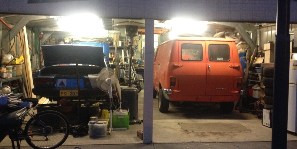

found a nice and cheap un-registered VS Commodore today so my brother and I went and picked it up. Not running, wouldn't even crank.
turns out all it was, there was no security ring around the ignition barrel so I removed the wire from the back of it and touched it on the key head and she fired to life
The previous owner has put new radiator, leads, plugs, fuel pump, coils and radiator hoses in it, its also got 4 good tyres and a pretty new clarion cd headunit and 6 x 9 speakers!
plan is to use the complete wiring loom, steering column, seats, fuel tank, central locking, diff, and such and wire it into the Bedford, then modify it to work with either an 808 loom or a 424 loom and 304/T700.
the only thing its missing is cruise control unfortunately but i'll either find that from another car or do without
oh and the lower control arms and mounts are getting transplanted into the Gemini!

lol yeah, although i say 202 at a matter of habit, its actually a big block 173
not sure if i'll ever use it for a race car motor or not, but its definately a smooth stock runner
going to be making a start on removing it tonight actually
not sure how hard it will be with the small amount of engine bay it has!

yeah im looking forward to getting motors in and out!!
i am planning to use the complete VS commodore wiring loom, along with steering column, dash cluster and fuel tank etc, so hopefuly it all just works like a commodore in that regard.
with the diff, i am not 100% certain on my path yet, i need to go to a wreckers and measure a crewman diff, but it will be either crewman diff or vn-vs diff, lengthened 4 inchs and use 2 long angles, this will get it pretty close to the bedford rear track from what i've roughly worked out so far.
i want commodore brakes and stud pattern, the rest will be up to whatever i can make work the best! but definately things like brakes and axles etc i want to be off the shelf parts as much as possible.
