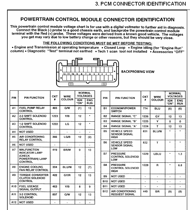

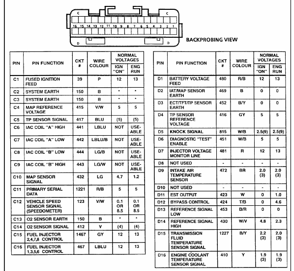

ok so here are the backprobing view of the plugs on a VS auto PCM.
so as you can see, D6 is diagnostic test enable. earth this wire to make flashy codes.
A7 is check engine light control, put this wire on one side of a light (pref not LED, they still glow a bit even when light is off) and the other side of the light to ign power. you should be able to pick up both of these wires at the little body loom interface plug just up the loom a bit from the pcm.
auto diagram 1.PNG (134.98 KiB) Viewed 2860 times
auto diagram 2.PNG (115.72 KiB) Viewed 2860 times
