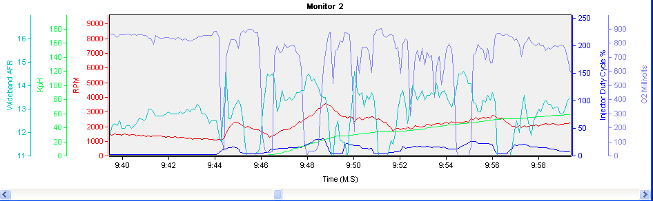

Got this one back on the road, and now have the naw_7s wideband installed and connected to the delco. The tune can be cleaned up some more from here.
