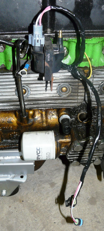

just a quick pic ....
ok, camira coil on the 202 .... you can buy the plugs from http://www.eficonnection.com ... i got the grey one with a tail, and then the black one (behind the grey one in the pic) comes with a length of wire then on the other end of it is the two pin connector for the camira ignition module.
I had to lengthen the loom to route it the way i wanted but either way it gets you all the plugs you need then you just use the IAC plug for the other one ... i think from memory it was $41 (us) including postage.
