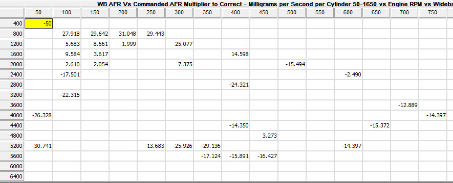

this is the results of that burnout data log, percentage of fuelling change required!
im also struggling to work out why my nvram doesn't want to work, when i get some more time will be testing a few things in that regard.

Wouldn't there be a lot of transient fuel changes going on during the burnout so not ideal data for tuning?

read my mind, you can here the throttle changes in the video

i'm not so worried about the richness on the top revs, its the 30% more fuel needed at 800rpm thats weird, its just such a massive jump to the change at 1200rpm!
