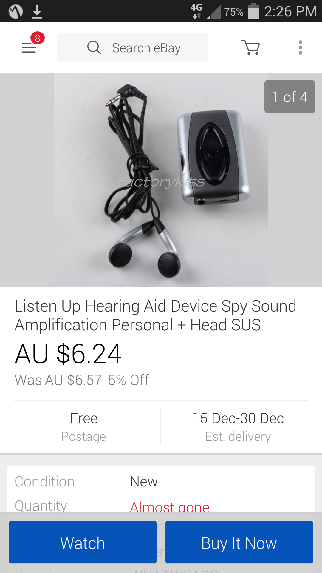

For hearing back in 2011 Delcowizzid recommended this https://pcmhacking.net/forums/viewt ... 244#p13529
The ebay link is dead, so i'll attach the pic of the device he was talking about.
I built one up, but never ended up using it.

Looks like you can still get them on ebay, looks the same.
item number 171948974837
