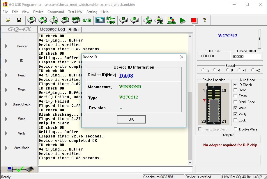

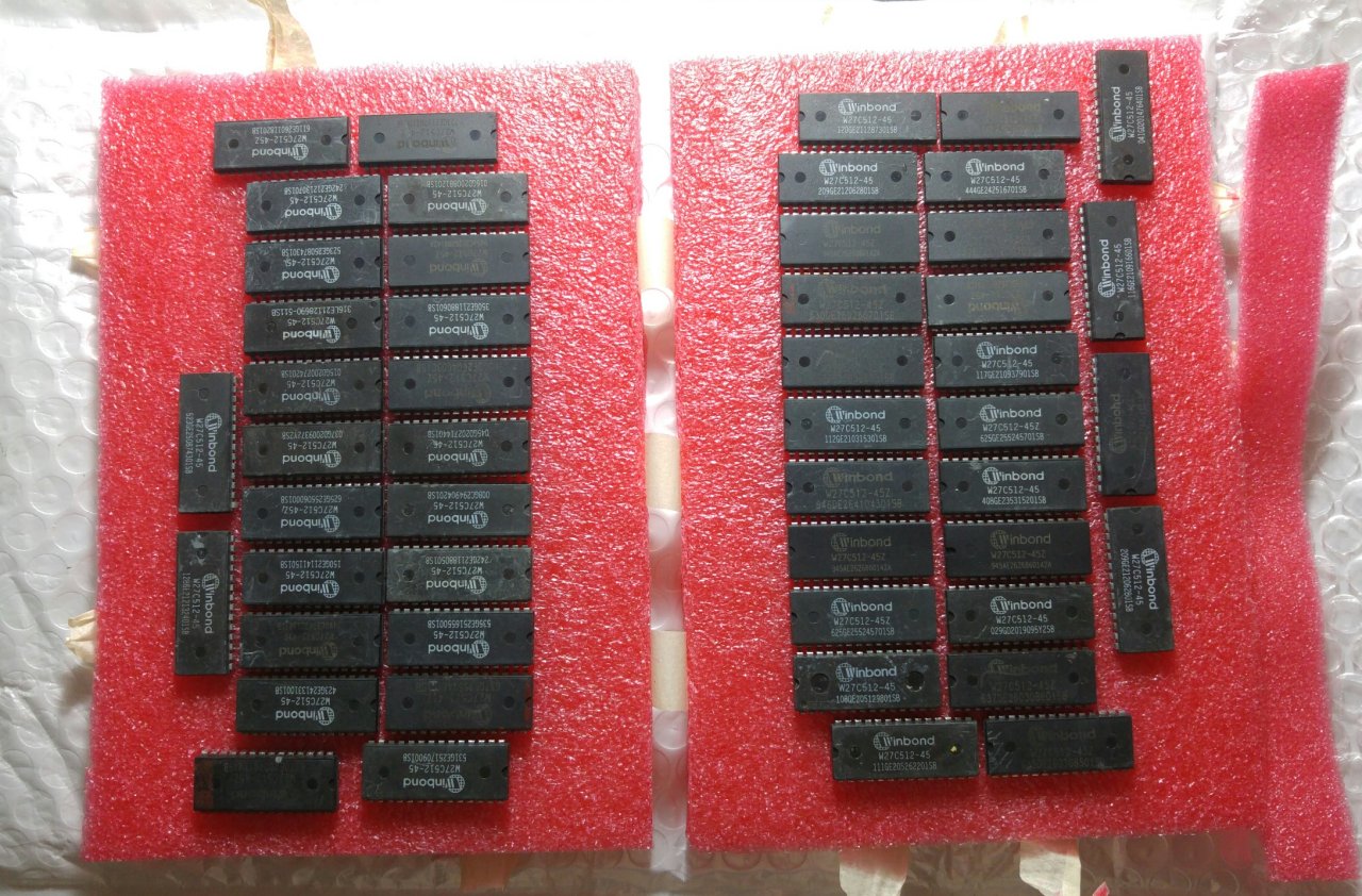

The ebay ones I linked above came though. As expected they're chip pulls, of varying colour and age. All winbond @ 45ns. Ive tested several of them (including some of the hardest ones to get out) and they all passed. GQ log shown. The one which failed was not sitting in the programmer well. I re-socketed it in the ZIF socket and it came out fine. They also were all blank, which backs that they have been tested after being removed from the computers or equipment from which they were pulled. 50 chips, $108au at the other weeks exchange rate.
I also tested the signed GQ v2.01 windows 10 drivers and flashed on windows 10 without trouble. Note that there is now a new GQ-4x4 model which is not compatible with the older ones and has different drivers too. The windows 10 signed v2.01 drivers are hidden half way down the official driver page @mcumall.com for the GQ model most of us have. They also report v2.00.
chip pulls gq.jpg (121.66 KiB) Viewed 8403 times
Ready
H/W Re: GQ-4X Re-1.40(SW Re. 6.38)
USB Driver Re.2.0
Software Re. 6.38
Checking new software on server...
This software is updated already.
<<W27C512>>
ID check OK
Blank checking... Buffer
Elapsed time: 2.27 seconds.
Chip is blank
s:\ecu\vs\bmzc_mod_wideband\bmzc_mod_wideband.bin.
ID check OK
Writing... Buffer
Elapsed time: 22.76 seconds.
Device write completed OK
ID check OK
Verifying... Buffer
Device is verified
Elapsed time: 3.85 seconds.
ID check OK
Writing... Buffer
Elapsed time: 22.77 seconds.
ID check OK
Verifying... Buffer
Device is verified
Elapsed time: 3.69 seconds.
ID check OK
Writing... Buffer
ID check OK
Verifying... Buffer
Device is verified
ID check OK
Verifying... Buffer
Verify Failed, Address=0x000000, Device=0xFF, Buffer=0x00
Verify Failed <---- not good contacts in GQ, re-seat and re-test same chip next...
Elapsed time: 9.02 seconds.
ID check OK
Chip is blank
ID check OK
Writing... Buffer
ID check OK
Verifying... Buffer
Device is verified
Elapsed time: 5.66 seconds.

Good to see you had a win on that one good buying for sure.
How long will that stash last you?
Posts: 8996
Re: Alternative EEPROMs
Forever... i still have some new winbonds from the1s last bulk buy. Im just a hoarder and want to be sure i wont run out :lol:
