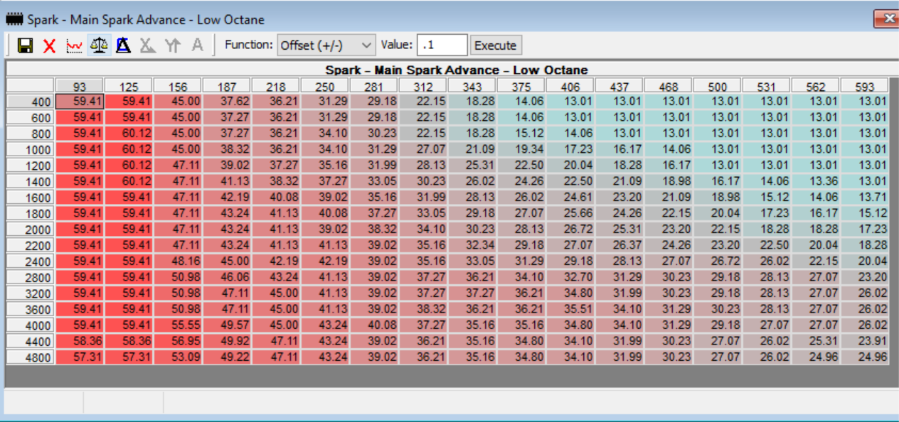

using the xdf and matching bin file for the vt i copied the spark tables and fuel maps and ms/gram the car didnt run at all
i used 325 ms/gram and advanced the timing untill it ran without stutter
my fuel rail runs at 90psi~15%
timing used for eliminating stutter on rapid acceleration/throttle movment

full credit goes to the-1's custom VT code
and again this is done without any tuning equipment
totally unbelievable calculations but apparently 272hp @ 205kw @ 542nm at the fly wheel that isn't a dyno test just a web based calculation but it projects an increase of 58kw on an unmodified ecotec at 23 degrees advance vs stock timing
can anyone shed some light on this
this is with a high pressure fuel rail
7.9 VT_V6_AUTO_$A5G_Enhanced_v1.1.bin
the1 enhanced vt bin what i have done so far
(128 KiB) Downloaded 456 times

trexbreah wrote:full credit goes to the-1's custom VT code
i reckon if you run 90psi oil pressure and 50psi in the tyres it might just make it, nearly as good as an oiled snake.
