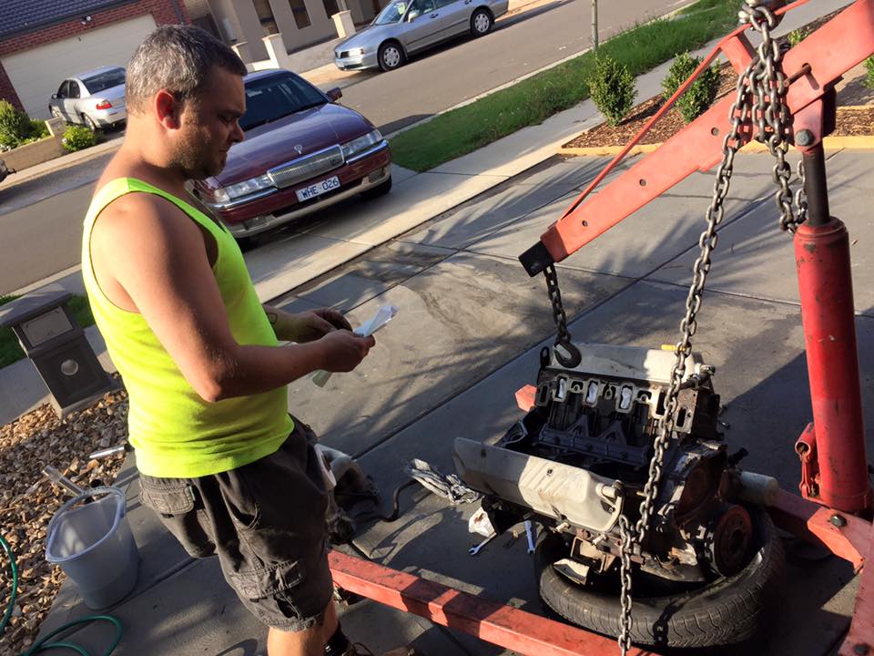

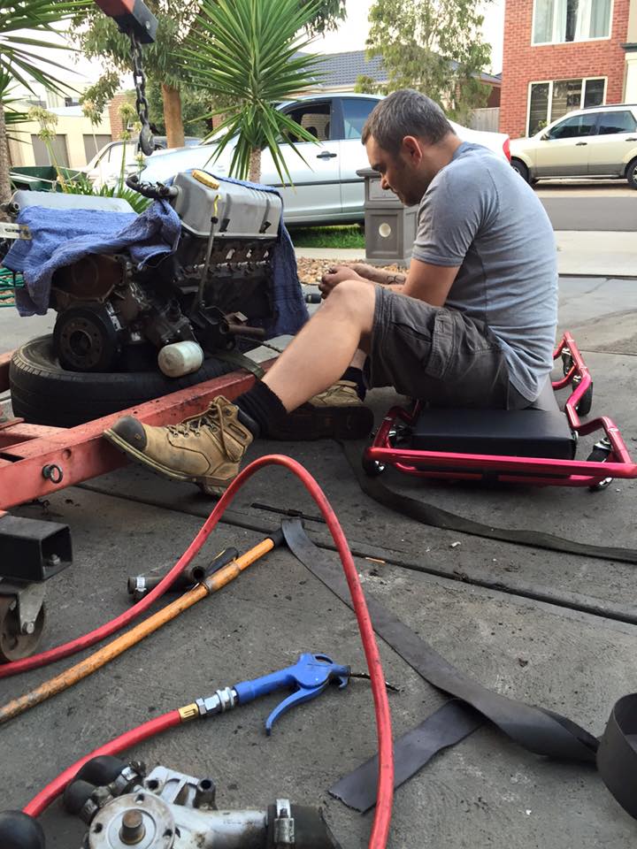

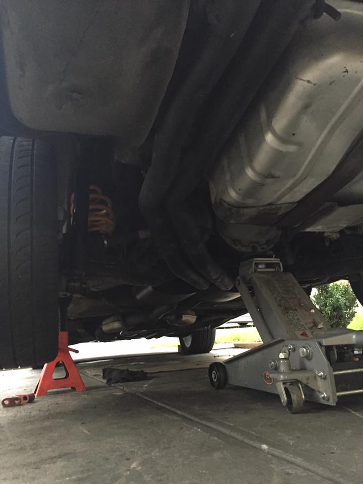

believe it or not, my older brother (aka) dickface. had never even done an oil change in his life before this moment of fixing up his vq. in fact I'm pretty sure ive never even seen the cunt work before this, hence why I had to actually get a few pics of him actually doing something. just in case no one believed me lol.

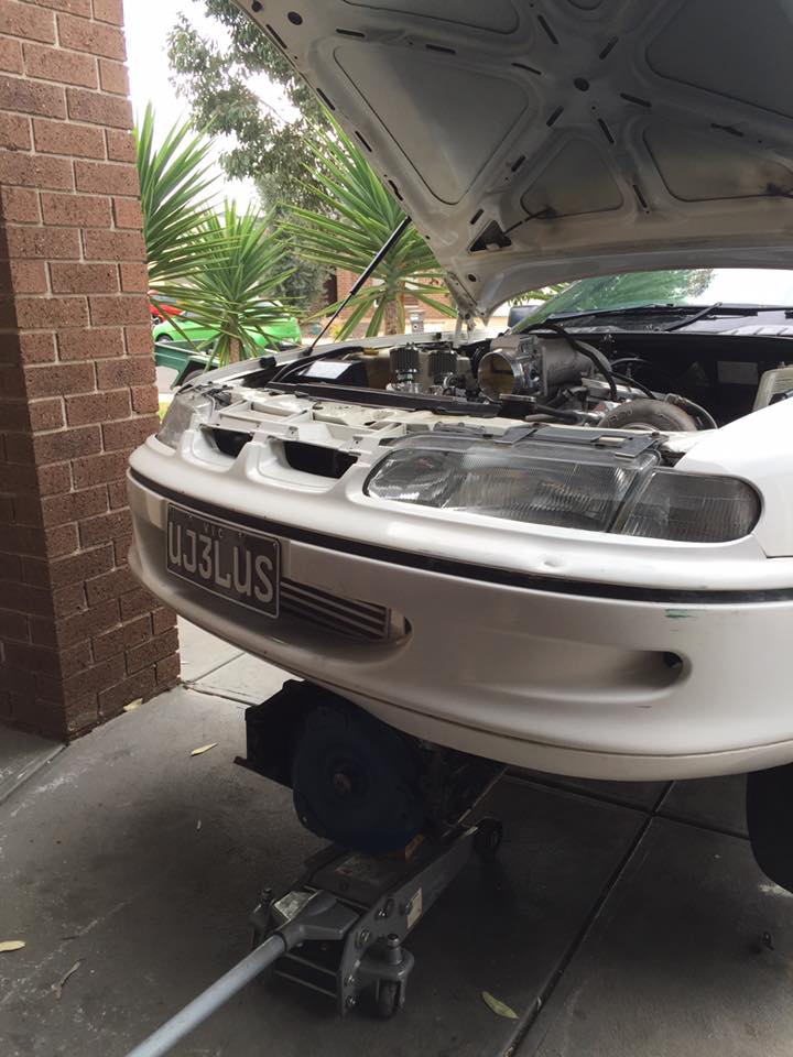

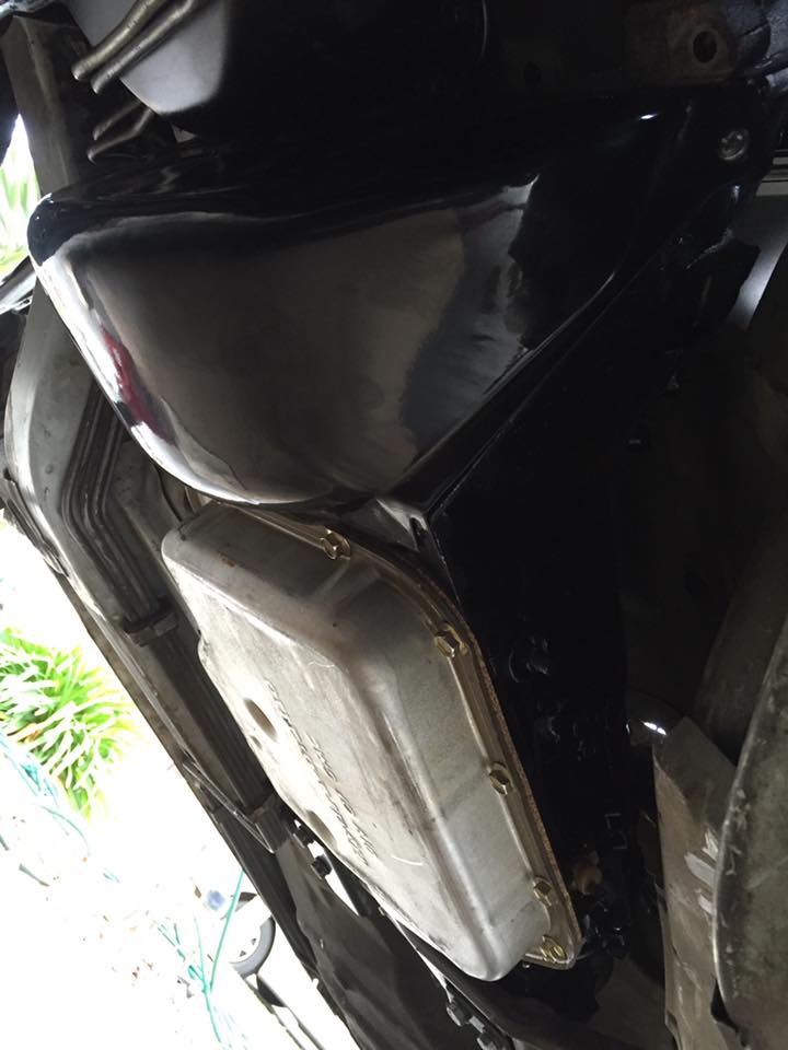

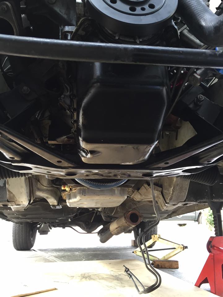

th400 finally in

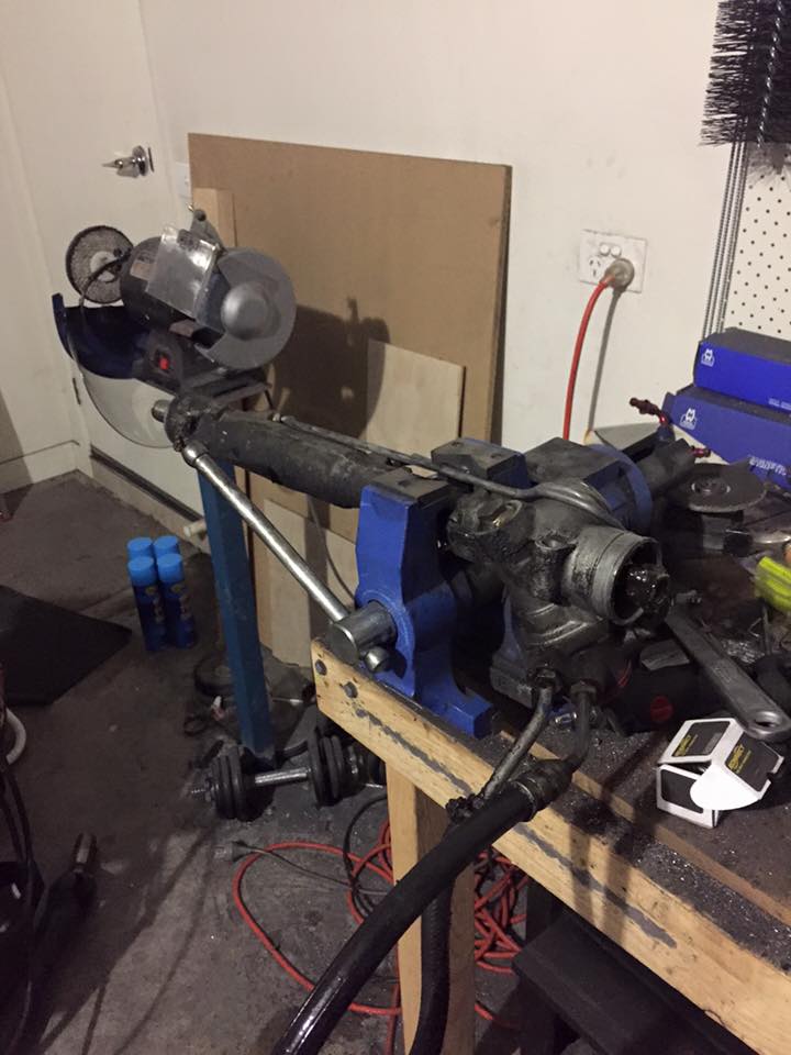

Re: my vr statesman, vr commodore and brothers vq

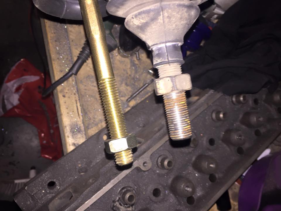

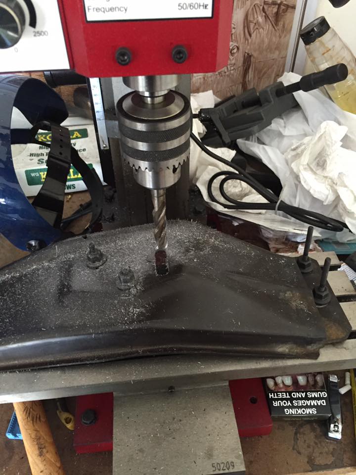

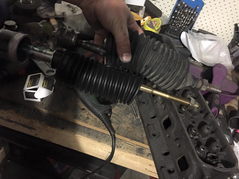

so whats the go with the steering arms, you needed the shorter ones with course thread to suit the correct tie rods ?
Wade
Posts: 1106
Post by Wade »
They were the same length, just the diameter was different. So I changed them off the vr power steering rack onto the manual vl one and kept the vr tie rods. I could of just left it the way it was and used vl tie rods but the vr ones are thicker and more beefy so I went with them
