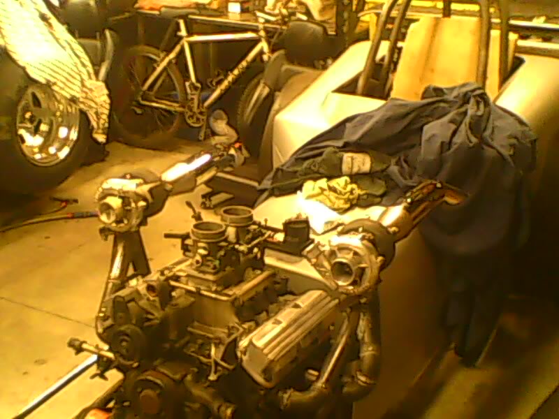

might have been the 2 half dead injectors LOL. its allways had a cylinder out at low TPS cruise or at least it sounds like 5 cylinders have never been able to tune it out ever since the conversion.runs great just sounds like 5 then you just touch the gas it goes 6 and pulls .today with the cam it was just not playing the game seemed impossible to tune what so ever .pulled over 2 injectors wernt pulseing as hard as the rest and dont make the engine stumble when removed so raided 2 injectors out the vr turbo and installed them and off she goes on 6 all the time now so it did a 12.6 on 2 sort of dead injectors LOL .we only just fixed that issue before dark so off for round 3 of tuning tomorrow

well turns out the guy selling the mig wire thought all flux cored wire was gassless turns out it was co2 sheilded flux core wire for heavy duty bizo no wonder it was shit LOL.
bit more done on this this week though

should be interesting chromemoly chassis weighed in at 57kg or something silly by itself LOL

hopefully not to long before shes fired up so we can see how the turbos go at spooling on the brake if we can get boost at a sutiable rpm we are laughing if not just add NOS to aid launches :mrgreen:
