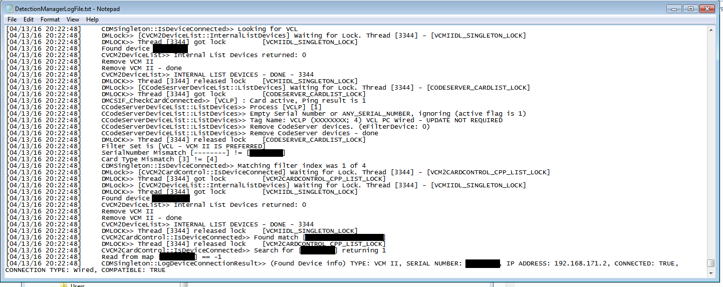

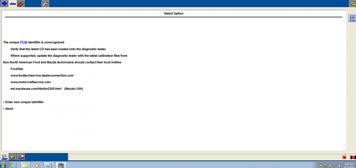

Posts: 9017
Re: Server/Networking Possibilities - Can it be done?
As for how the comms work - vcm 2/mdi etc provide a usb ethernet interface physically in the device then pc comms layer is ip. Thats also how they support ethernet and wifi on models with the hardware. The device is an embedded linux machine talking ip to the pc software. I cant speak for vcm 1 though, it could be something else.
The devices are basically the same too. I got my gm mdi talking to ford ids with pc side registry and driver hackery. For all i could see it was working looking for the car but i didnt have a ford to test against. Ok tangent on. Sorry....
Heres a pic of that hybrid combination. I love the mix of red and blue device icons. I think hell freezed over. :lol:
I had a GM '0411 connected so IDS couldnt identify it but the relays were clicking in the MDI and it appeared to be doing exactly what I expected with the right timing looking for a ford device.
