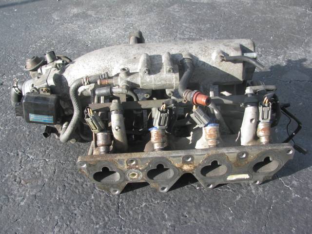

Mazda MX5 B6 1.6l intake manifold
That is the intake I'm using
Alternatively to an under dash sensor, I could use one of the vacuum ports already there with a short hose and fix the sensor to the manifold. Maybe tap a hole in the back end above number 4 runner.
Pretty sure Ill have to block holes off anyways as I wont have as much stuff connected for my motor.
Not sure what TB ill be using. I do have a vx commodore unit sitting around, but that will be too big i suspect, making throttle response hard to tune when too much air flows in just off idle. A 3.8l TB vs the 1.5l motor - just a little over-sized!
Was hoping to use the Mazda TB, sans MAF sensor, (for bolting simplicity to the Mazda manifold and its for a 1.6l) but I'm not sure if the TPS on the Mazda unit will work with the delco 808. If it doesn't, ill make something that does behave with the delco fit. An adaptor plate, whilst fiddly, is easy enough to make.

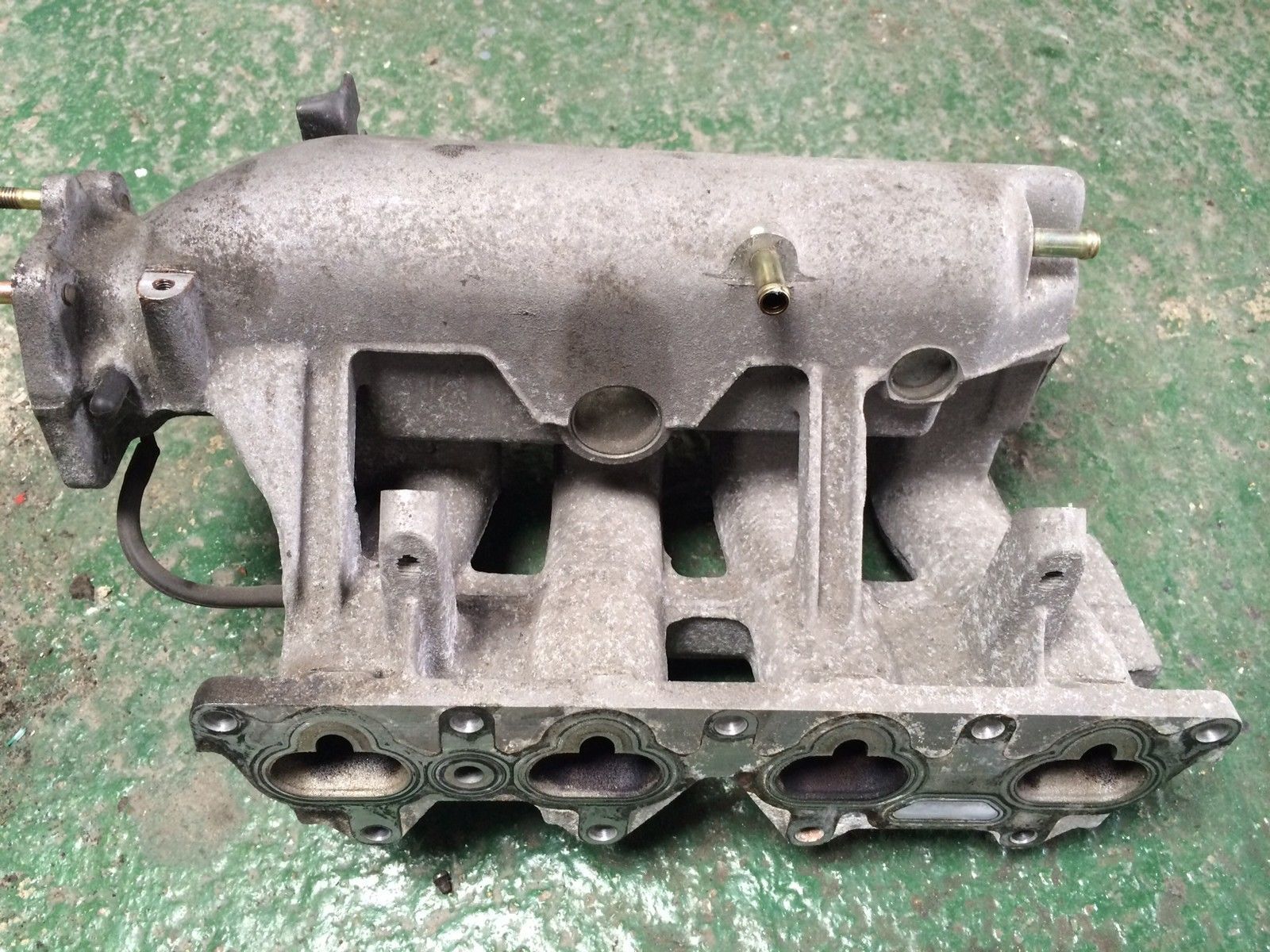

Mazda MX5 intake manifold NA 1.6l - with all the mazda bits attached

Not sure what the Mazda throttle switch is but you need a variable resistor type that matches a Delco. As far as throttle bodies I used a VN on a 2 Litre engine and it's perfect with throttle response but I understand your concerns. The Vectra had what I consider a dam built into half the manifold so that the progressive opening of the throttle was very small on one side and open on the other so you may be able to weld up the opening on one side of the throttle plate to achieve just that.
