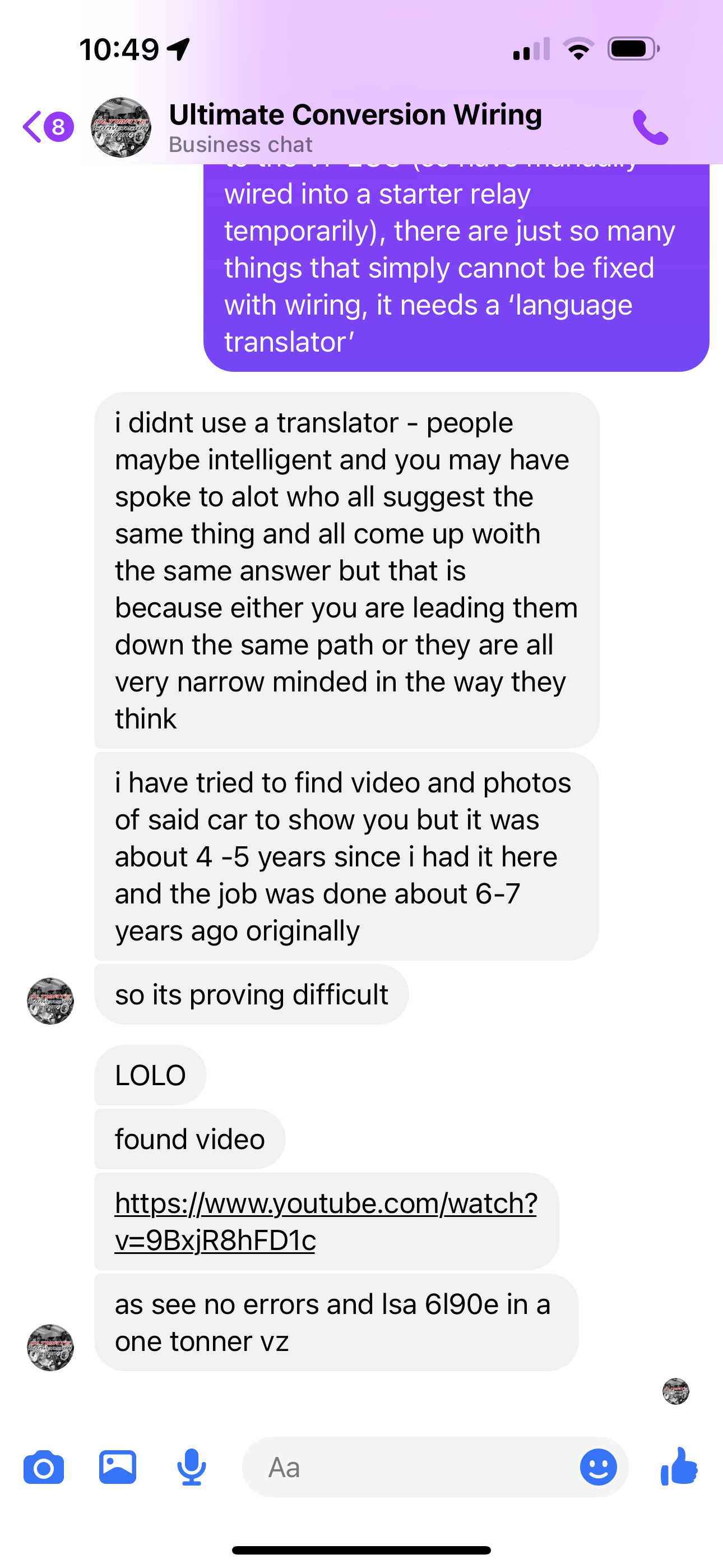

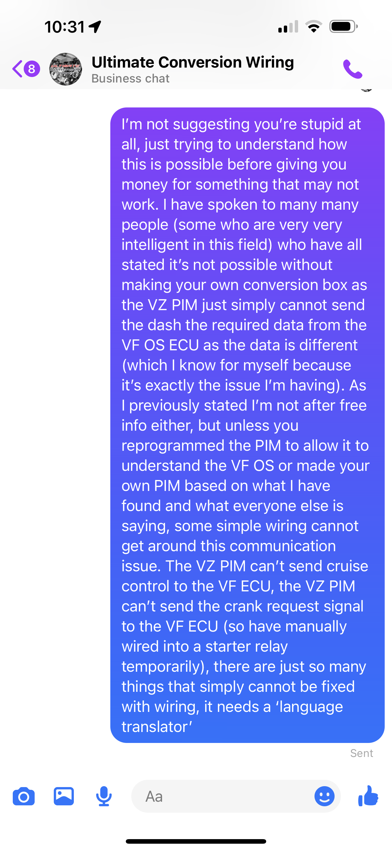

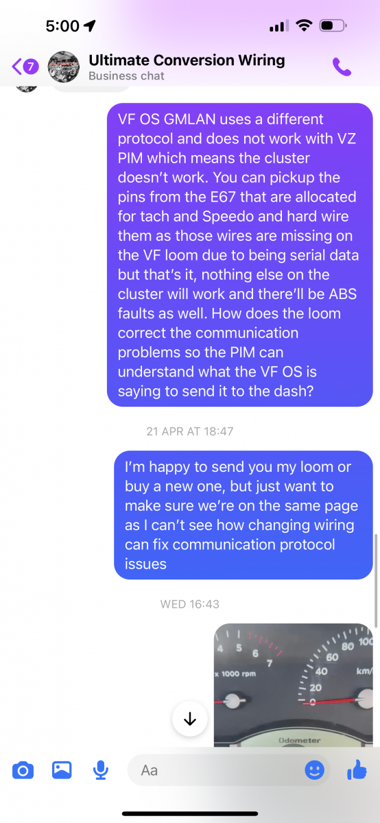

Seems adamant that he has got the VF OS ECU to work with a VZ dash even though no one else that I have spoken to can. The VZ dash does not have discrete wiring for the fuel gauge, temp gauge, alternator fault, oil pressure etc where as the VY dash has some of those things inputted via discrete signals, it needs to be communicated via the single wire from the PIM which interprets from the two wire GMLAN. The PIM doesn’t like the VF OS, I have tried V6 and V8 PIMS, all different types of eeprom configurations and no success.
I know I’ve got some spelling mistakes and probably used the wrong words in some instances, but most people will know what I’m saying in the below screen shots.
He seems to think that a loom will fix the communication issues however I can’t see how this is possible unless someone else here can confirm?

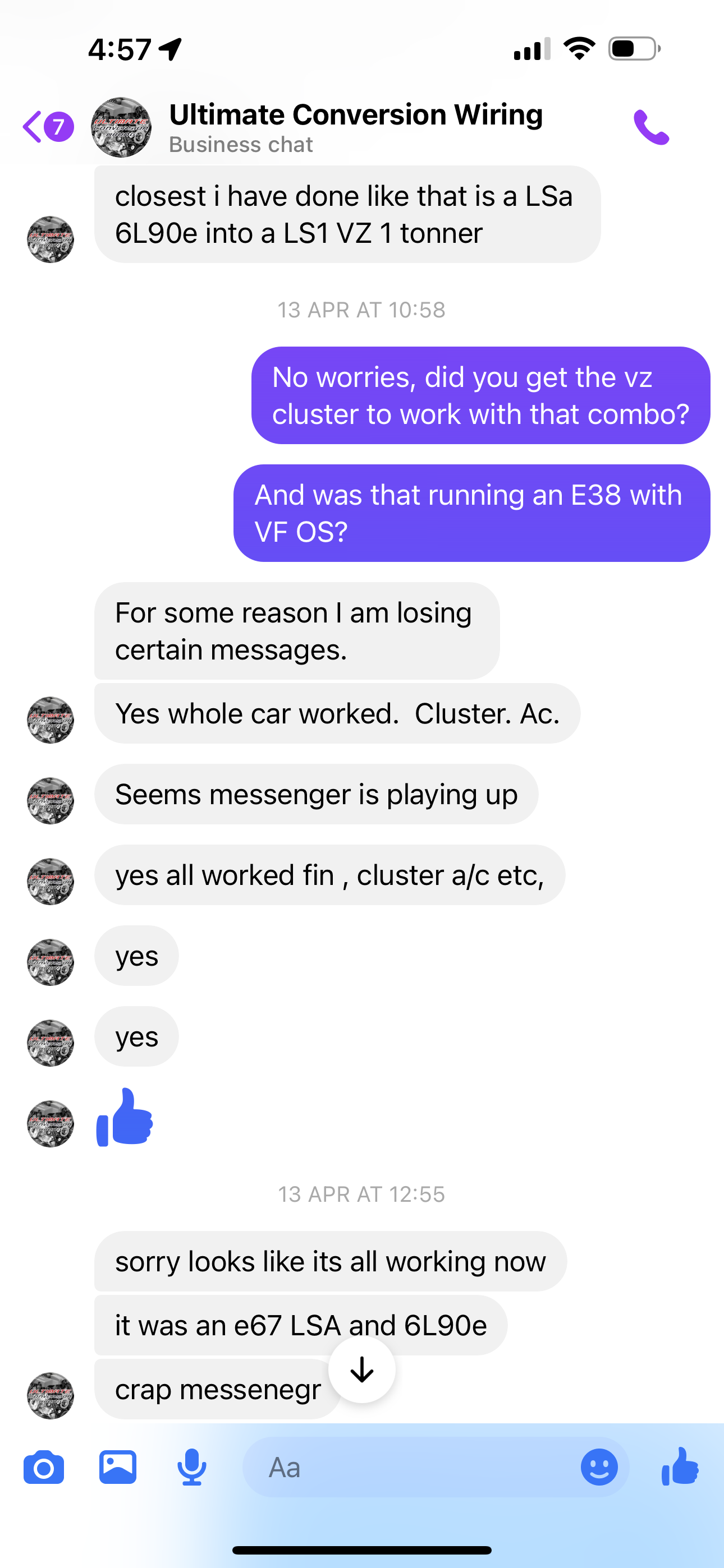

It sounds like one of their customers claimed they did it, but they don't know how, and they just do looms. Did the customer get it working? 100%? We'll never know. Perhaps not, unless they made their own PIM replacement.

It is, isn't it? I messaged him back for a price for the special wiring that can somehow make it work but he hasn't responded yet, I do like the 'we're all narrow minded', but can't explain how he did it other than it's just wiring and no interfaces/conversion units required. The thing I find most concerning about sending him money to build a loom is I just can't see how wires can make the PIM understand the VF OS or get ALDL data to the cluster.
Out of curiosity I got a VZ cluster out and fired it up, I tried applying 12V and ground to all the pins that have no assignment on the schematics and got nothing.
I also tried using a resistor across each of those pins to ground and to 12V as I know with the VY cluster if I apply 12 or gnd to the fuel gauge input it doesn't move, needs to measure a resistance and still nothing.
So I thought maybe he had found some pins on the cluster that could be used for those signals and just pickup the senders/sensors directly to the dash, but that's a no go either.
The only other thing I can think of is he's either modified the PIM code to be able to read the CAN data from the VF ECU OS or he's modified something in the VF ECU to send out messages the VZ PIM can interpret, in any case, happy to pay him to do it, but without being able to be forthcoming with anything other than 'it's the loom', which doesn't seem possible makes it hard to trust that he's the real deal.

I deal with Justin all the time, he definitely isn't a bullshit guy. but what he is saying he has working is a E67 in that vz. completely different from your situation wanting it to work with the e38. the e67 still had the earlier can or serial support can't remember which.
VZ dash had fuel level come via can, VY was still hard wire.
I have a vy running a e38/6l80 combo, i had everything working except for coolant temp so i put in a powertune dash cluster.

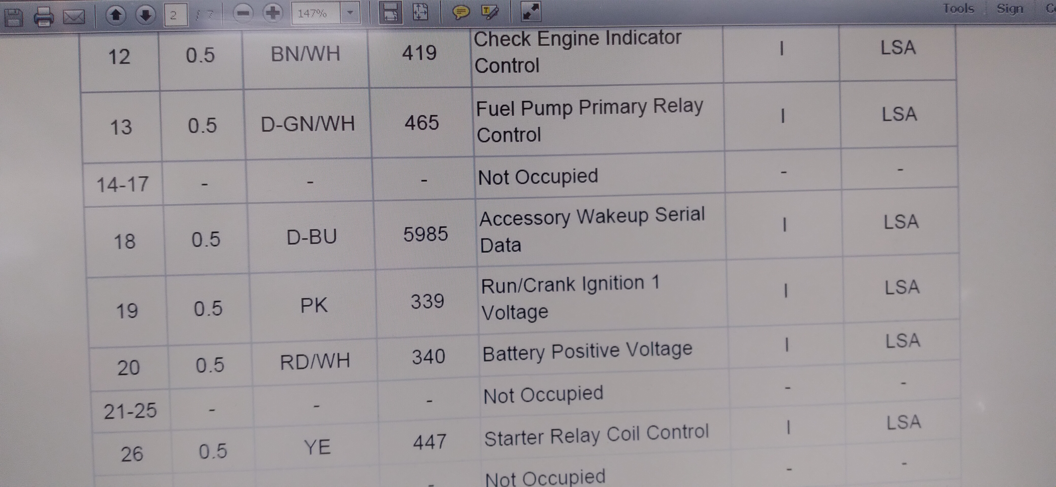

In-Tech wrote:Hiya folks,
I am wanting to do an e67 and t43 to a 2003 chevy truck and dash so I will be experimenting in a couple months.
There is some serial data coming from the e67 but not sure how much.
That pin will not help you at all, First I though it was some low speed CAN, but when I investigate further, it is some simple signal to wake some modules. To use vpw dash with CAN pcm, you will need at least CAN ->VPW converter box that will translate messages between modules. Not sure if it exist. Or use a pcm that can talk both vpw and CAN as e40 for example.
