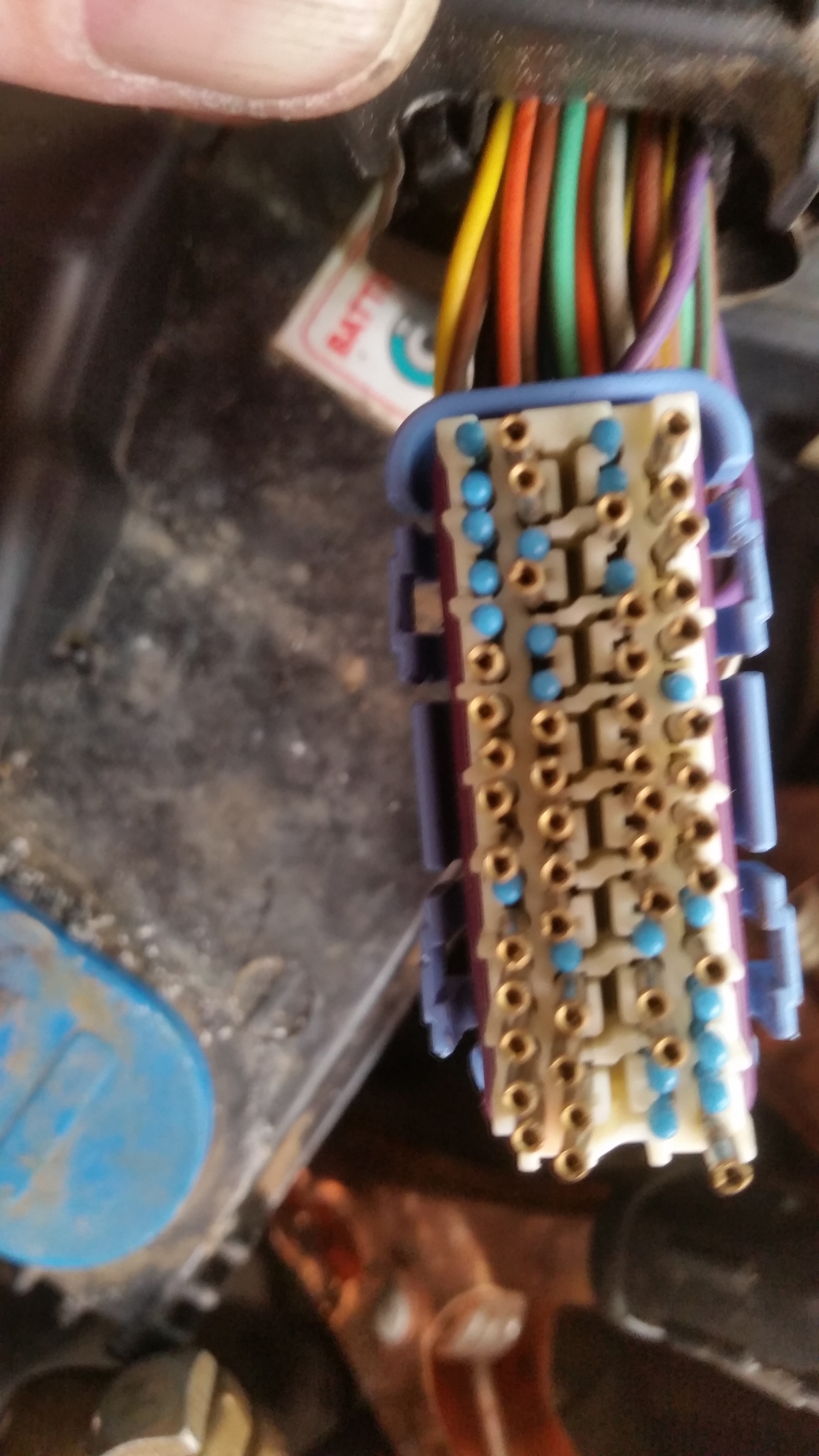

I looked into the wiring and thought the only loom left is the one from ECU into the cabin, so I took the Delphi connector apart OMG these don't look right :wtf: see picture pin holes not round... would this loom have any effect on the cam sensors? I checked engine loom pins they look brand new.
Madmatt2006
Posts: 373
Joined: Fri Aug 31, 2018 4:48 am
cars: VZ SVZ Commodore
VH Commodore
JZZ30 Soarer GTT
Location: Katandra West
Re: VZ engine swap not running
Post by Madmatt2006 »
Hi Guy's back again with an update I fixed the pins in the loom from ecu to cabin no difference :hmm: but I did find another thing :)
