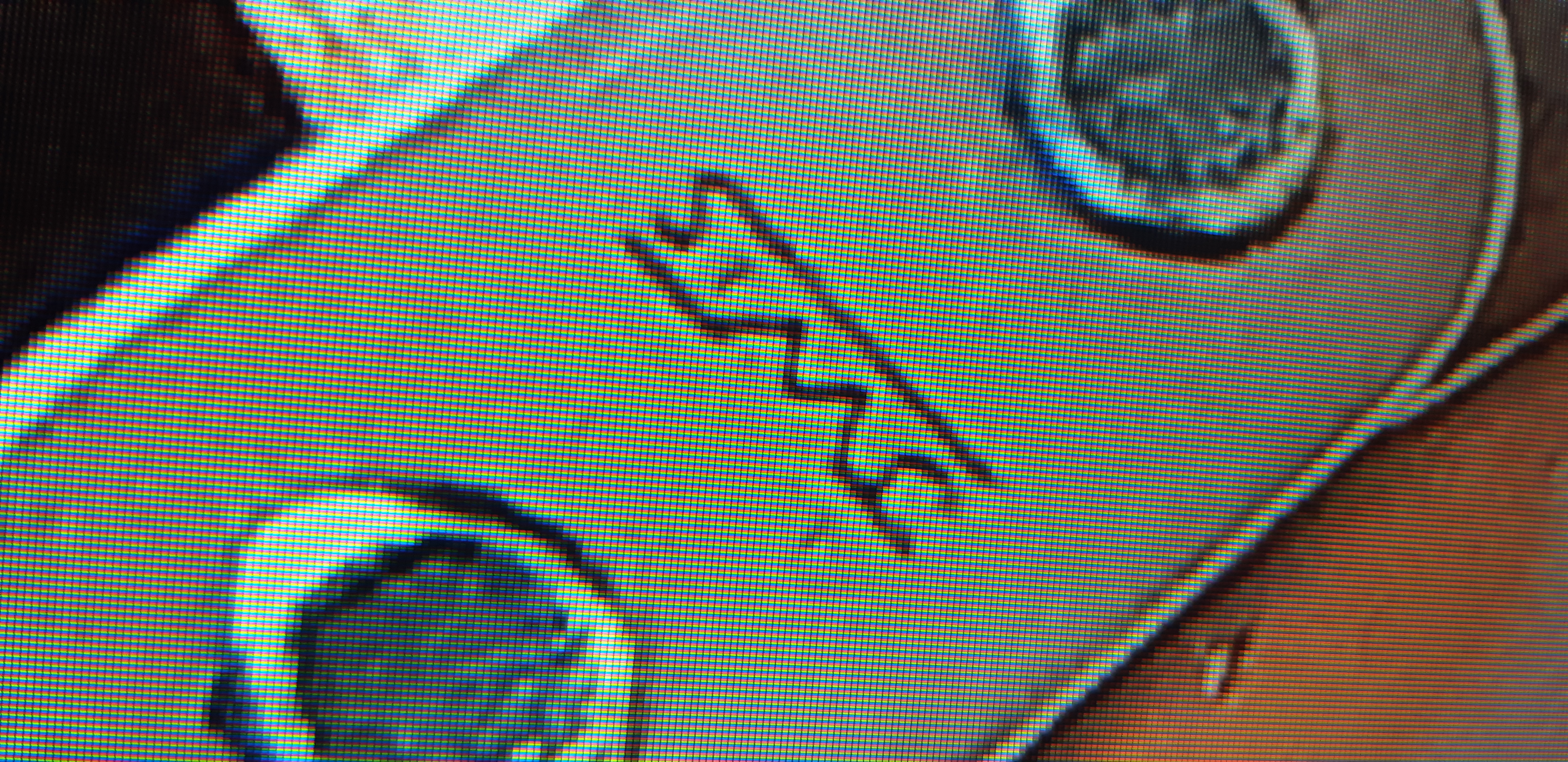

Was there a name stamped on the side of the links of the JP Timing chain ?
Re: VS Ecotec Timing Chain
yeah thats a JP performance chain. some sellers that list roll master actually ship you a JP one. I only heard about them recently and seemed to have come out of the wood work. Don't know much about that brand.
Well it was a crow cam box I got from Repco, the chain has a JWS stamped on it.
Anyway it fired up perfectly, a small tick noise for about 3 secs then disappeared. The cold starts are instant now, used to be like 5 to 6 cranks on a cold morning.
I didn't take into consideration the tensioner wear against the aftermarket chain. I guess the aftermarket won't stretch like the stock version.

The marking on your timing chain is good as it is the German brand that Rollmaster use. I think JP originally used another brand chain at first, which didn't work out to well for them or a lot of users of their chain kits.
But in saying that, a lot of failures have pointed back to faults with install & setting up on the double row timing chain kits.

Just enlarged the photo and yes it is a jwis, a tiny i between the w and the s letters. I read they are the choice of chains for Mercedes and BMW. What sort of mileage does the tensioner itself last? I guess this type of chain should last longer than the factory version?
