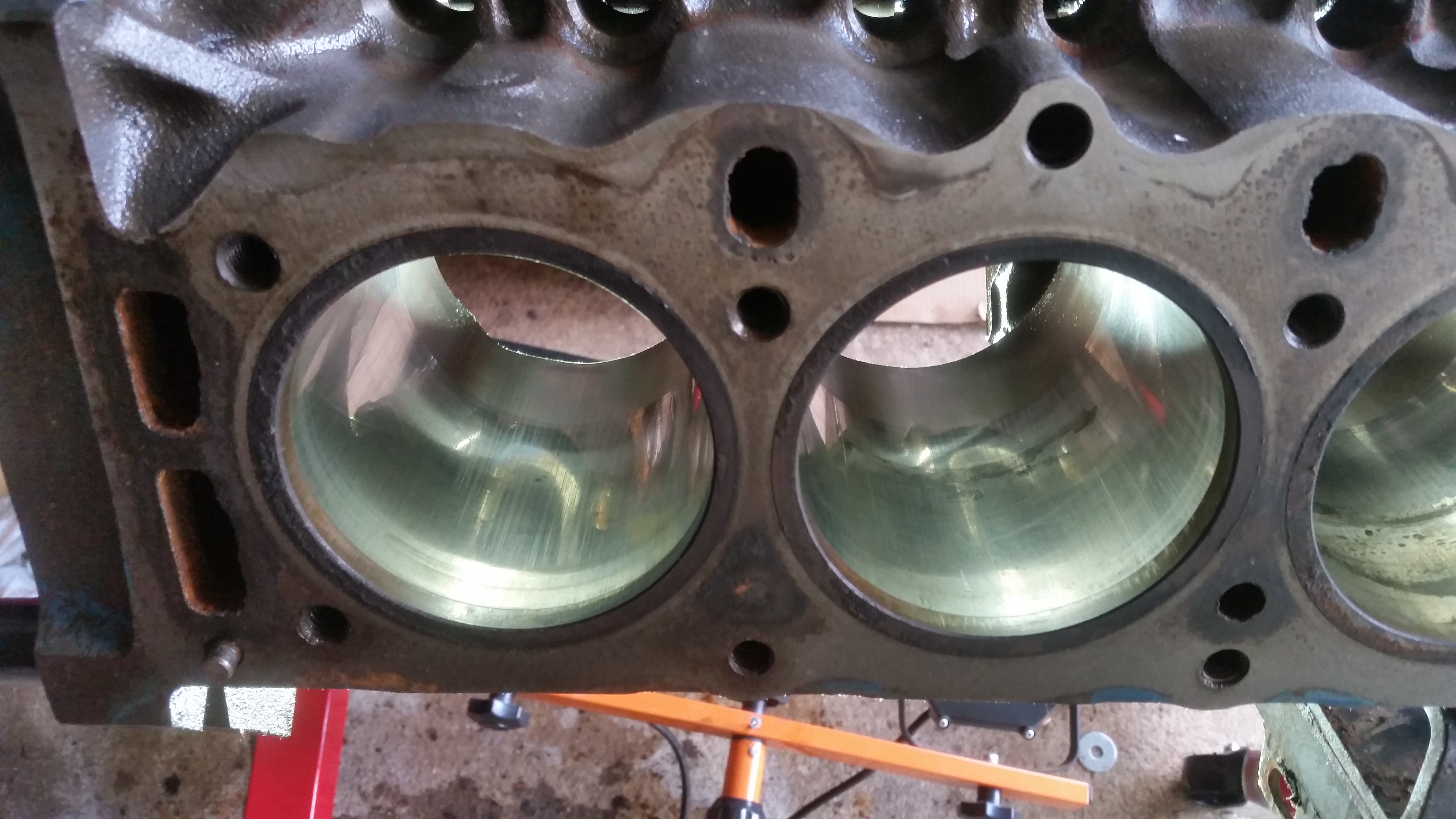

It's not that simple, the engine has to be completely dismantled, then bore the particular cylinder out. Have you got some pics of the pitting?

Here is a picture of the cylinder that is stuffed after cleaning . Ill take crank pistons out and take a few pictures to postv6bucket wrote:It's not that simple, the engine has to be completely dismantled, then bore the particular cylinder out. Have you got some pics of the pitting?
- Posts: 2332
Re: 253 V8 carby selection
O-boy ... That's not good!
A complete tear down will be required, that's for sure.
As an ex machine shop owner, We refused all requests to mix new bores with old bores.

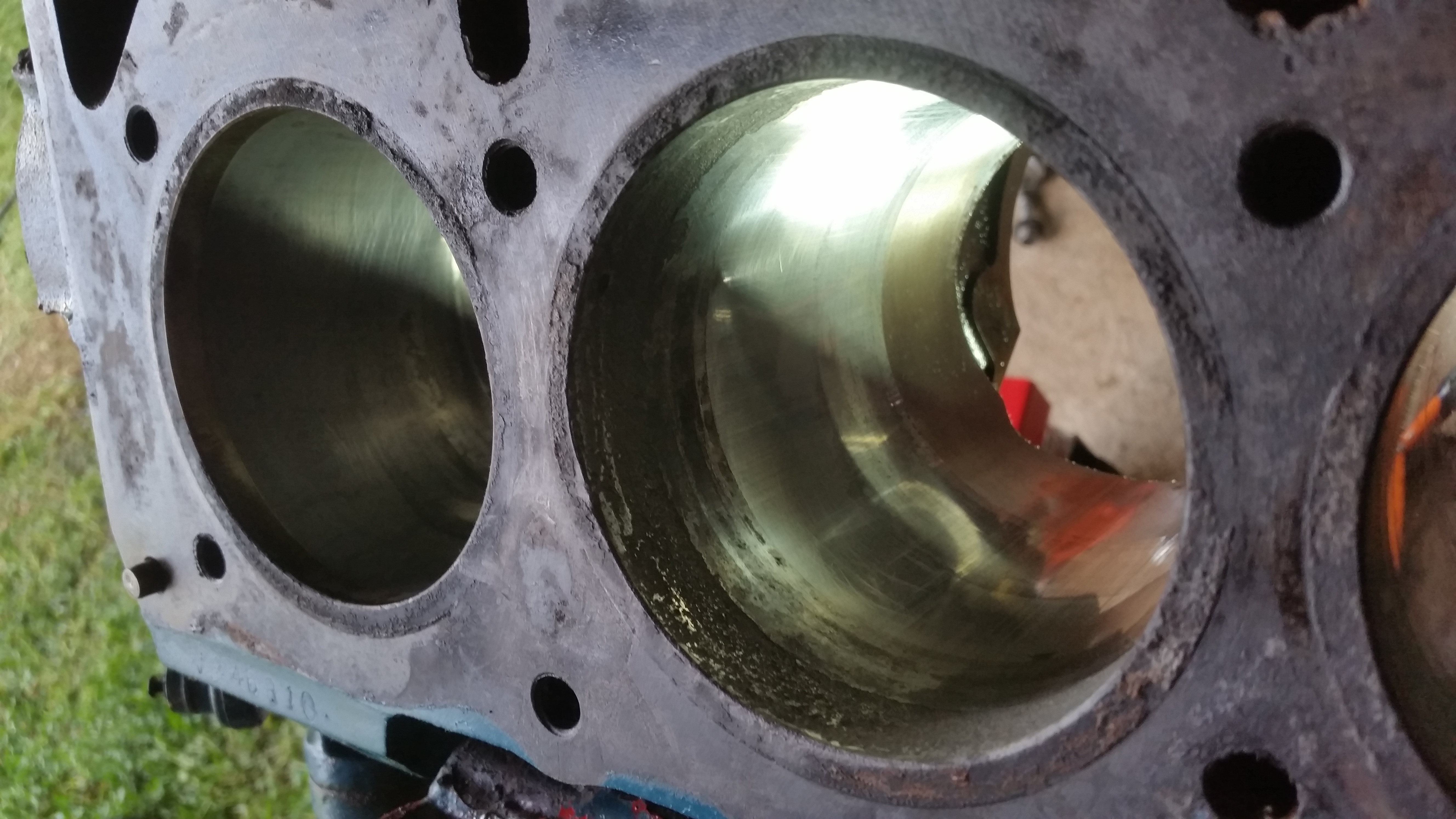

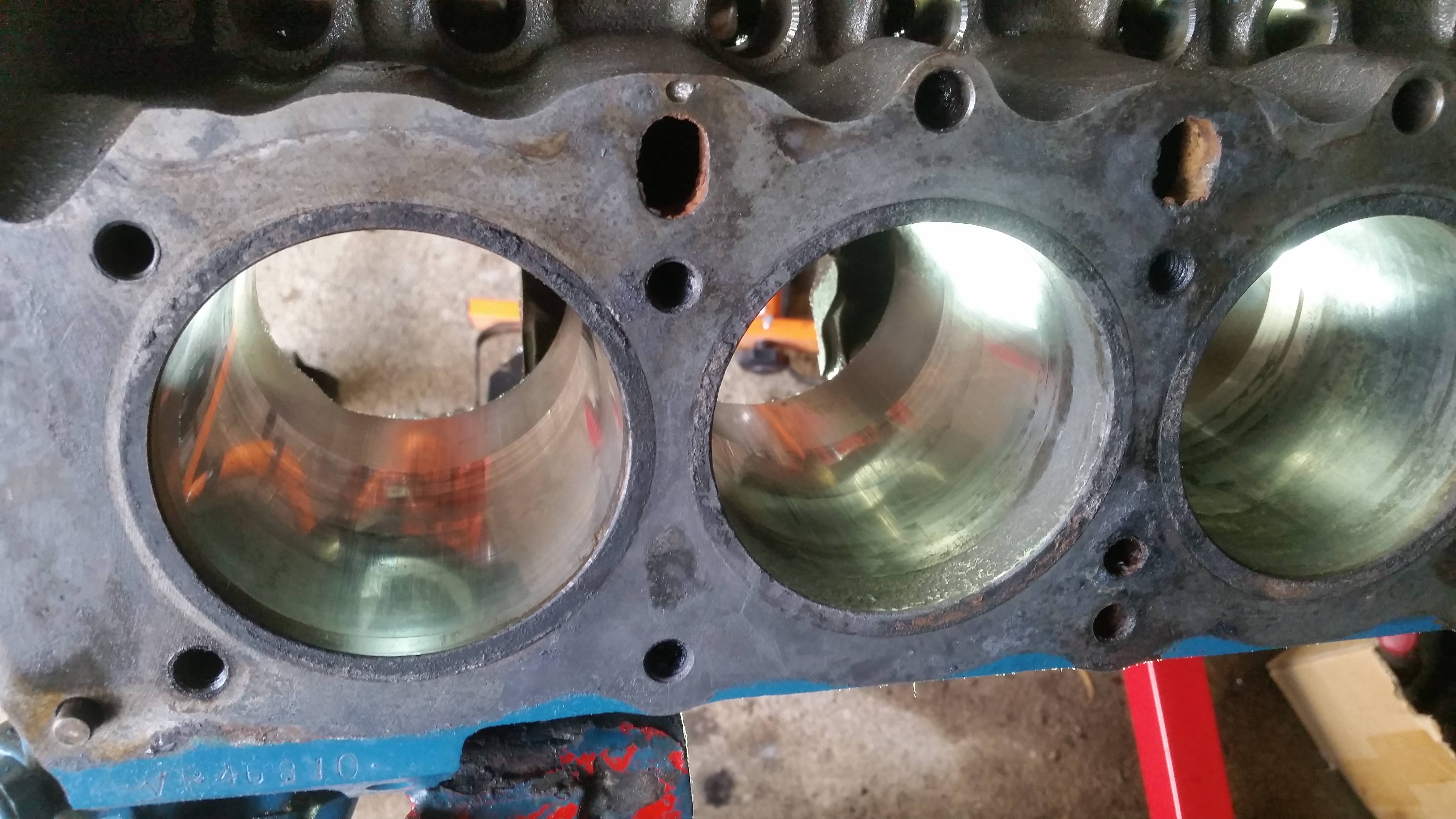

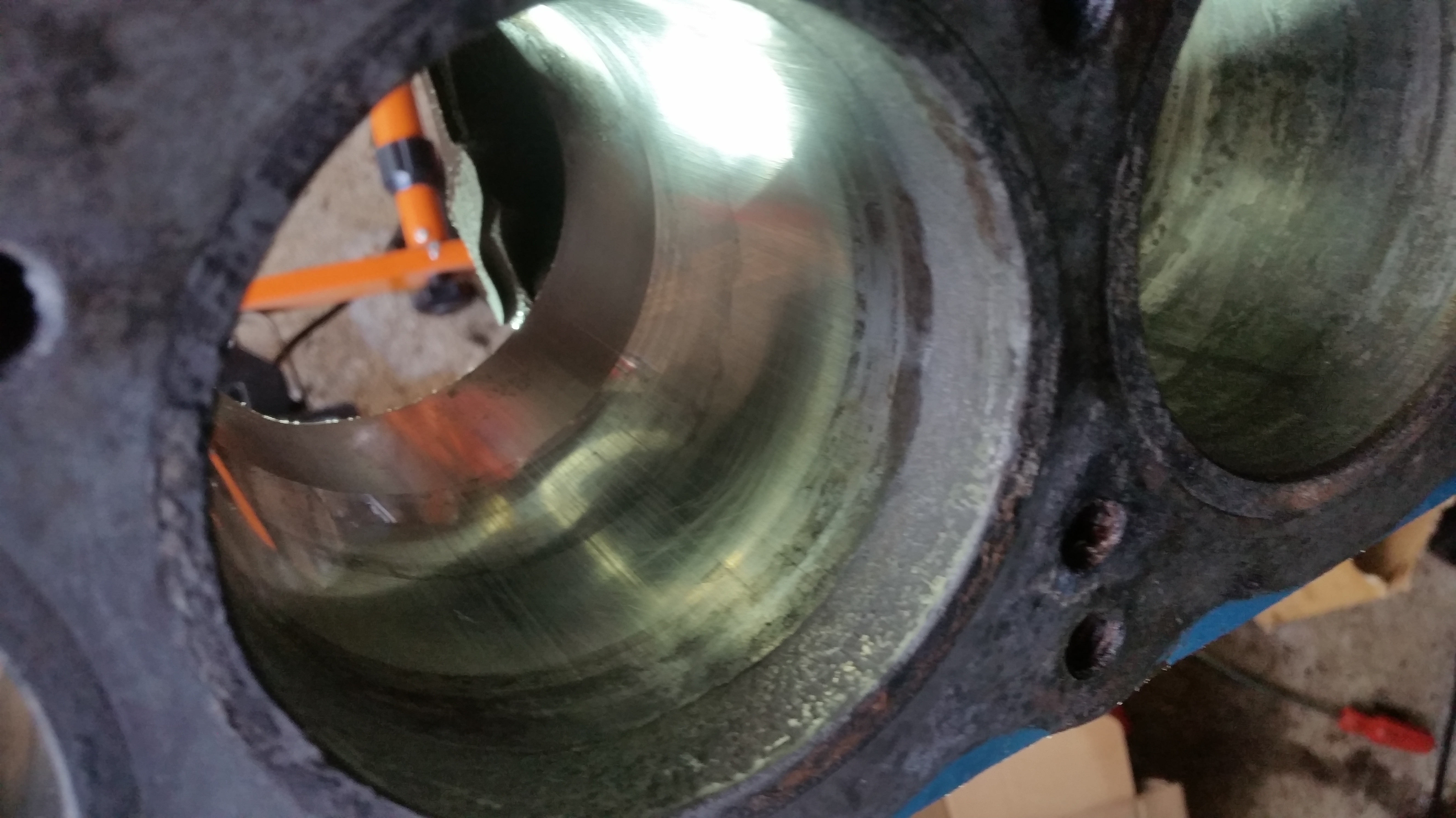

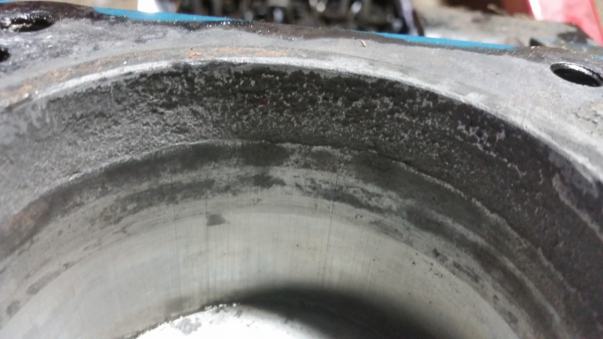

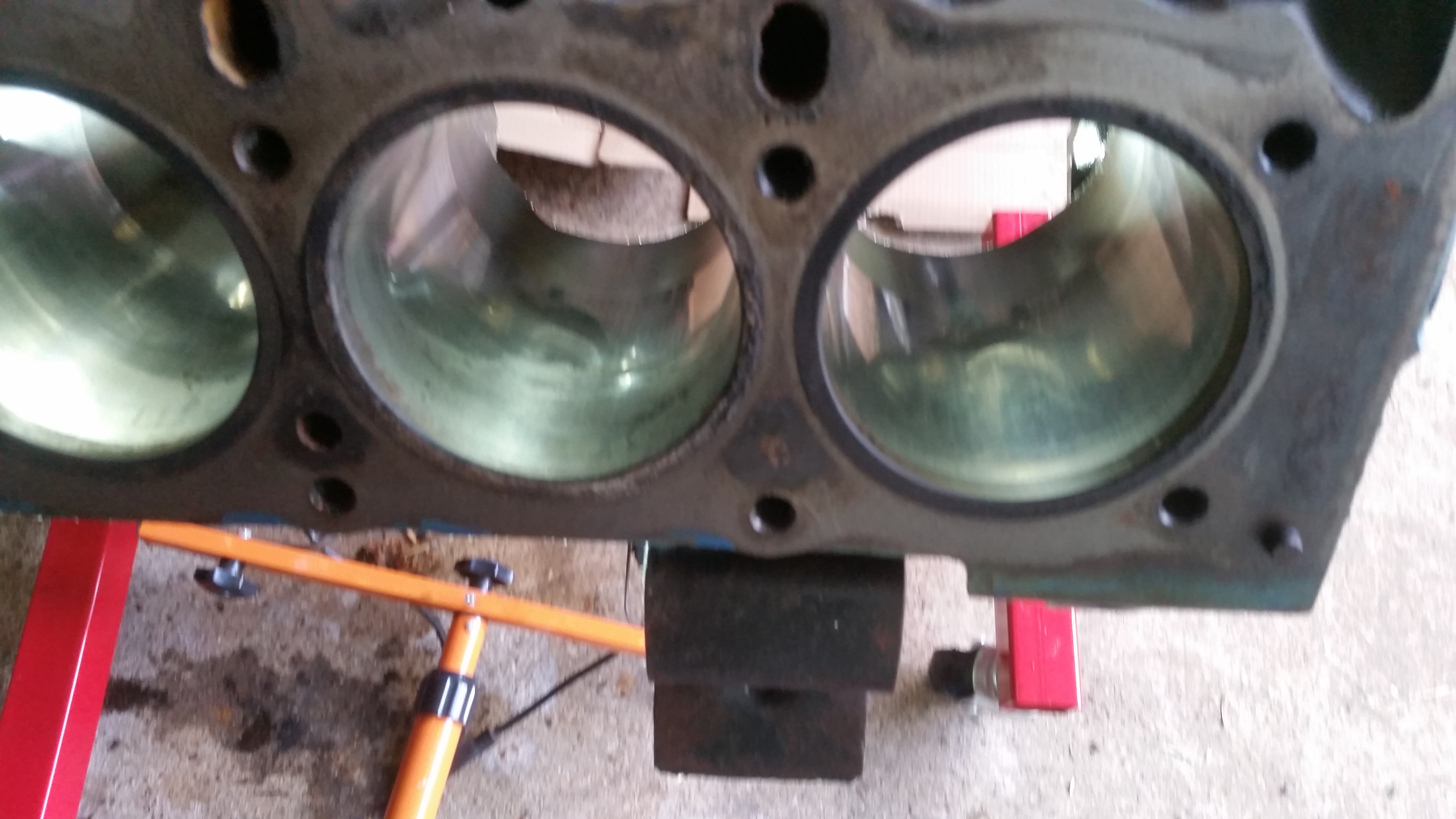

Hi Guy's got the engine apart everything looks pretty good except for that cylinder and the valves above it
can you take a look? the engine came a part easy! lifters, pistons, crank nothing was stuck!
