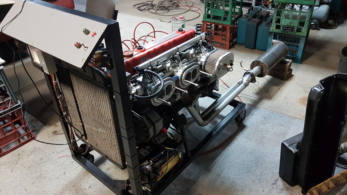

Finally finished my test rig today. Stock VK EFI engine with VK injection removed and 45mm ITB's fitted, dizzy locked, BIM148 module conversion done, base timing set to 10 degrees, 0 208 155 777 injectors. 808 ECU with NVram and comms board mods done and original V6 memcal and knock filter plugged into the NVram board. 38psi fuel rail pressure. No MAP or MAF. Want to configure for Alpha-N but not sure how to do that just yet. No o2 sensor connected at the moment.
When I ordered the NVram I requested that Holden202T's basic tune for VK EFI be loaded.
When ignition is switched on Check Engine Light comes on and the fuel pump prime works and fuel pump relay turns off after the timed delay. On start the fuel pump turns back on as soon as there is crank rotation and it tries to fire straight away but will not continue to run. I've tried different throttle positions etc but will not run. Pulled the plugs and all have been firing and not wet, in fact they look fine.
I then attempted to connect with TunerPro wth OSE_$12PV112_1BAR-Petrol.adx and oseplugin180.exe both loaded. The cable test was OK. When I attempted to connect to the ECU the yellow connected status indicator changed to blue but then changed to red (DA Data Error) and it then just alternated between blue and red with the error count continually incrementing. I could not resolve this issue. I did try turning "Echo" ON but it would not connect at all with "Echo"On so I turned it back OFF
The dashboard shows the battery voltage as 12.8V but the throttle position does not follow actual throttle changes.
Sorry for the lengthy post. I would greatly appreciate some help and guidence.
This is my first experience with the 808 and this rig is so that I can get a base tune for the ITB's so that when I bolt them up to my good 208 motor it will fire up first time and I can run the new cam in etc. I hate running cam lobes.

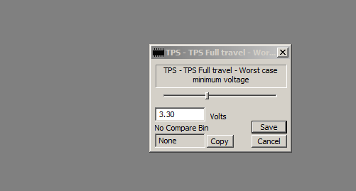

I have been trying to get the TPS correct. 0% throttle is 0.24V and 100% throttle is 3.02V. In the ADX Editor/Values/TPS Voltage, I entered these values for the Range Low and Range High and saved but the dashboard is still only showing 91.2% throttle at 3.02V. Am I on the right track here and do I have to now push these changes down to the ECU somehow. If so I haven't worked that bit out yet.

You don't want to change it in the ADX as thats only how tuner pro displays the data and not how the ECU is processing it.
I had a look and the only setting I could find was this one. Default is 3.3V Maybe you can try lowering that value?
