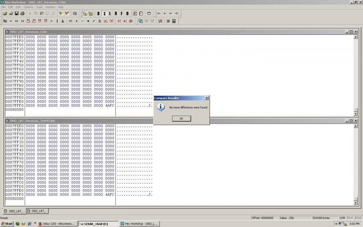

In-Tech
- Posts: 785
- Location: California
Re: LB7 Duramax E54 ECU
Did a compare in Hex Workshop
In-Tech
- Posts: 785
- Posts: 10015
Thats a win! So what do we need? Kernel needs to be smaller, load a bit higher, and the app needs to handle a priority 6C kernel upload response. We have work to do, but we have the answers. Good work Gampy and In-Tech!
