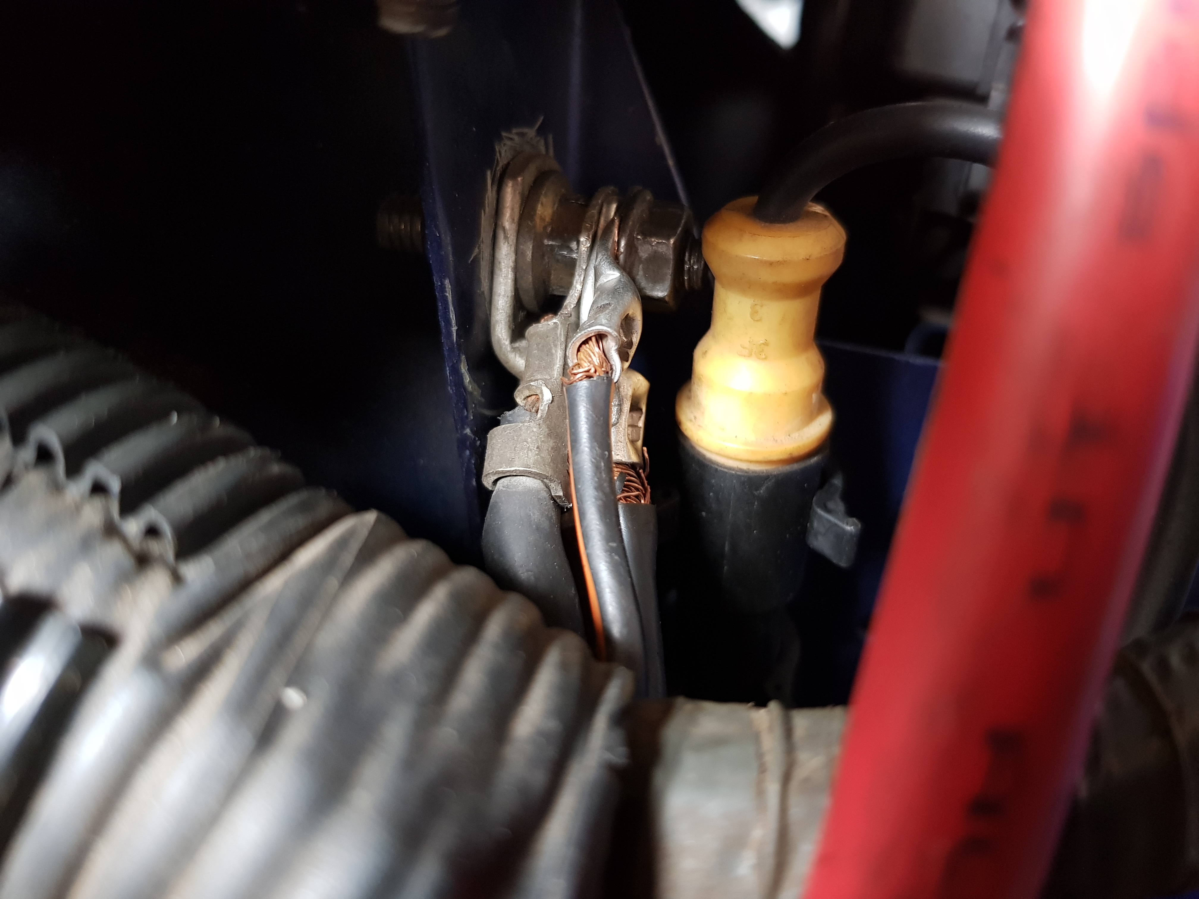

I decided to start checking my grounds as that's the next point in checking, now i thought i had a bit of a shitty wire connection on the black wire with red trace (might be orange trace?) that gets bolted to the ground point under and in front of the ABS module so i re did all these just for peace of mind. Sure enough it kinda started better and kinda ran a little better but i cant really confirm that the ground points were an issue or was just a coincidence? But one thing i have now noticed i can make the engine revs drop dramatically and even stall if i push up and down on the drivers side guard pretty abruptly and the issue pops up so this to me must sound like a wiring issue somewhere? Id do the same test on the passenger side i can create it but it takes much more effort so I'm thinkin my issue is on the drivers side? so I'm wondering if a full engine harness swap might be the go but if I'm to go do that can it be done easily enough while the engine is still in??

Ground point under ABS module. I did forget to mention i had upgraded the ground point here years ago and added a single 4 gauge wire from this point to the neg terminal on the battery to stop lights dimming with the stereo install. Heres some pics of the balancer if anyone else can spot something but to me seems normal?
Re: Cam sensor signal missing
I would do a 'wiggle test' on the 'Ground point under ABS module' in the pic., if you haven't already.
The crimping does not look sufficient from the photos.
Throw in a couple of star washers for good measure. I prefer crimp and solder.
I'm still leaning towards earthing/ connection.
