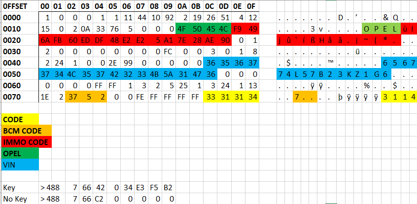

Looks like about 1E-2D would be the security data for the ECU link, 3 strings are sent in the relink and this is right size, data changed on the first relink but not after that.
Other bytes might be related to options? and pin codes.

The1 wrote:Looks like about 1E-2D would be the security data for the ECU link, 3 strings are sent in the relink and this is right size, data changed on the first relink but not after that.
That would be my assumption.
Other data in here....
Software Version:       Not in eprom, possibly mcu 220904
Hardware Version:     0B (h)12
Eprom Version:          0002 (h)00 (h)01
Manufacturer Change
Index:                       05   (h)13
Production Date:        (h)17 (h)18 (h)19
Identifier:                  0101 (h)04 (h)05
PartNo:                     92180030 (h)08 (h)09 (h)06 (h)07
Serial Number:          000000088027 (h)18 (h)19 (h)16 (h)17 (h)14 (h)15
VAP Process
Number:                   12 (h)47
TIS Hardware:          12000000 (h)60 (h)61 (h)5E (h)5F
VIN:                    (h)5D (h)5A (h)5B (h)58 (h)59 (h)56 (h)57 (h)54 (h)55 (h)52 (h)53 (h)50 (h)51 (h)4E (h)4F (h)4C (h)4D
Security Info:
Sec Code:                        (h)7D (h)7C (h)7F (h)7E          Linked 30-39 x 4          Reset 00 x 4
Sec Code reset count:       (h)2E

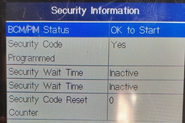

BCM/PIM STATUS:           ?
Sec Code Programmed:   (h)76     Linked  FE     Reset  FC

And win.
Changed some numbers from 11.bin
test.bin
(128 Bytes) Downloaded 573 times

Here is what ive worked out so far
PIM.xlsx
(11.32 KiB) Downloaded 514 times
