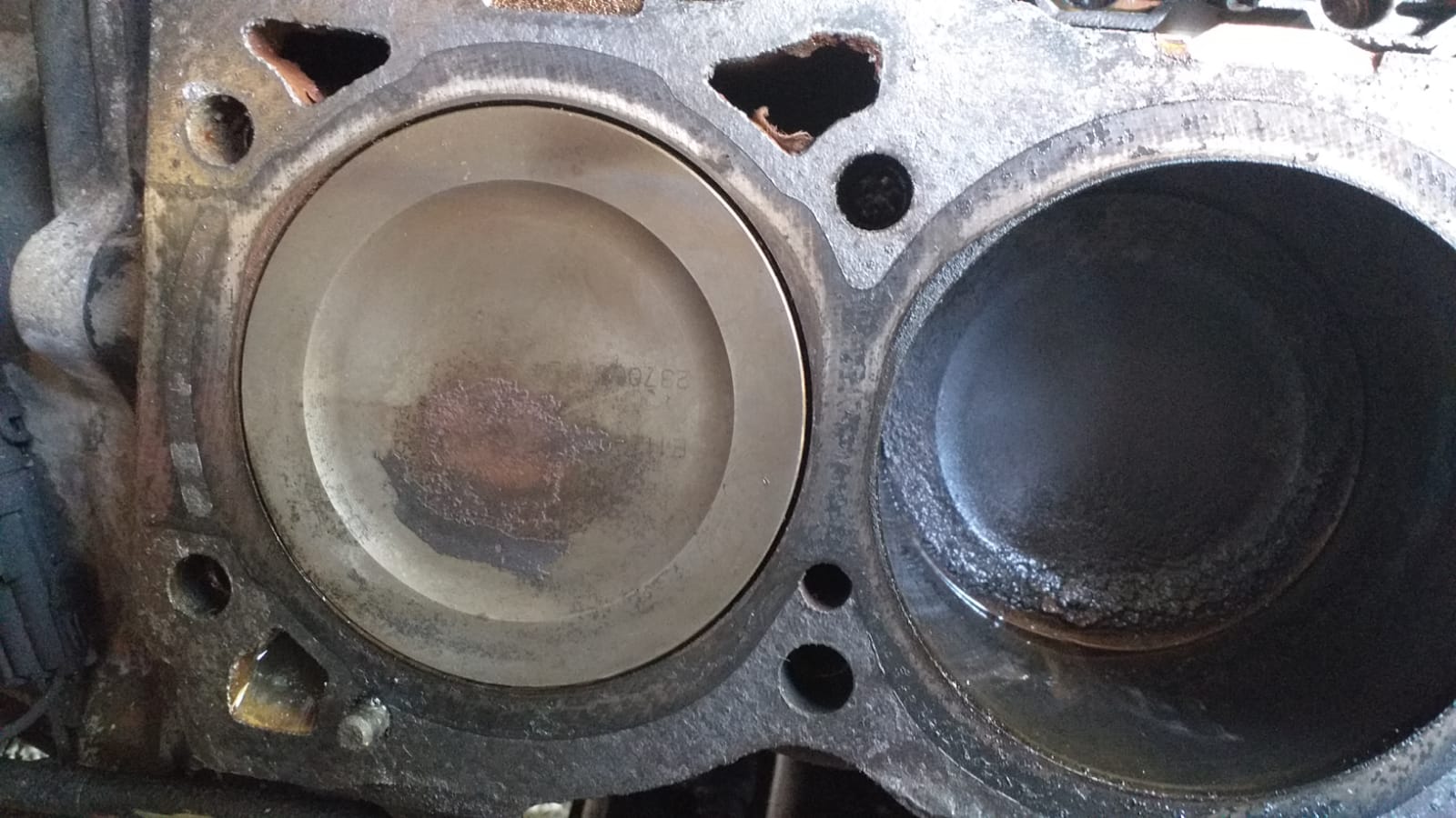

I've looked at this photo with zoom, is there something going on here?
- Posts: 2332
Re: Project Rescue
If that turns out to be what it looks like ... that's one helluva catch via image!

I haven't had a good look yet, just a cursory wipe out and spray with WD40 to prevent any more rust after I finished pulling the heads.

Your pic had me intrigued so had to check it out.
Gave it a quick clean with some WD40 and a rag, Looks all good. It does look like there is a crack running through the middle now but that is just the edge of a little bit of carbon left on the piston crown.

What does the R.H. head look like? The photo was of that cylinder head.
I flipped the image as it was easier to see...

I've had the heads soaking in WD40 to soften the carbon buildup.
There was one bit of carbon in the place you highlighted, scraped it it and wiped it down and it looks fine. I have been scraping around the valve with a fine point looking for cracks so maybe you're seeing little lines from that? Will be able to see much better once I get em fully stripped down and cleaned.

Definitely looks better now it's cleaned

For some reason it looks worse in pictures?
