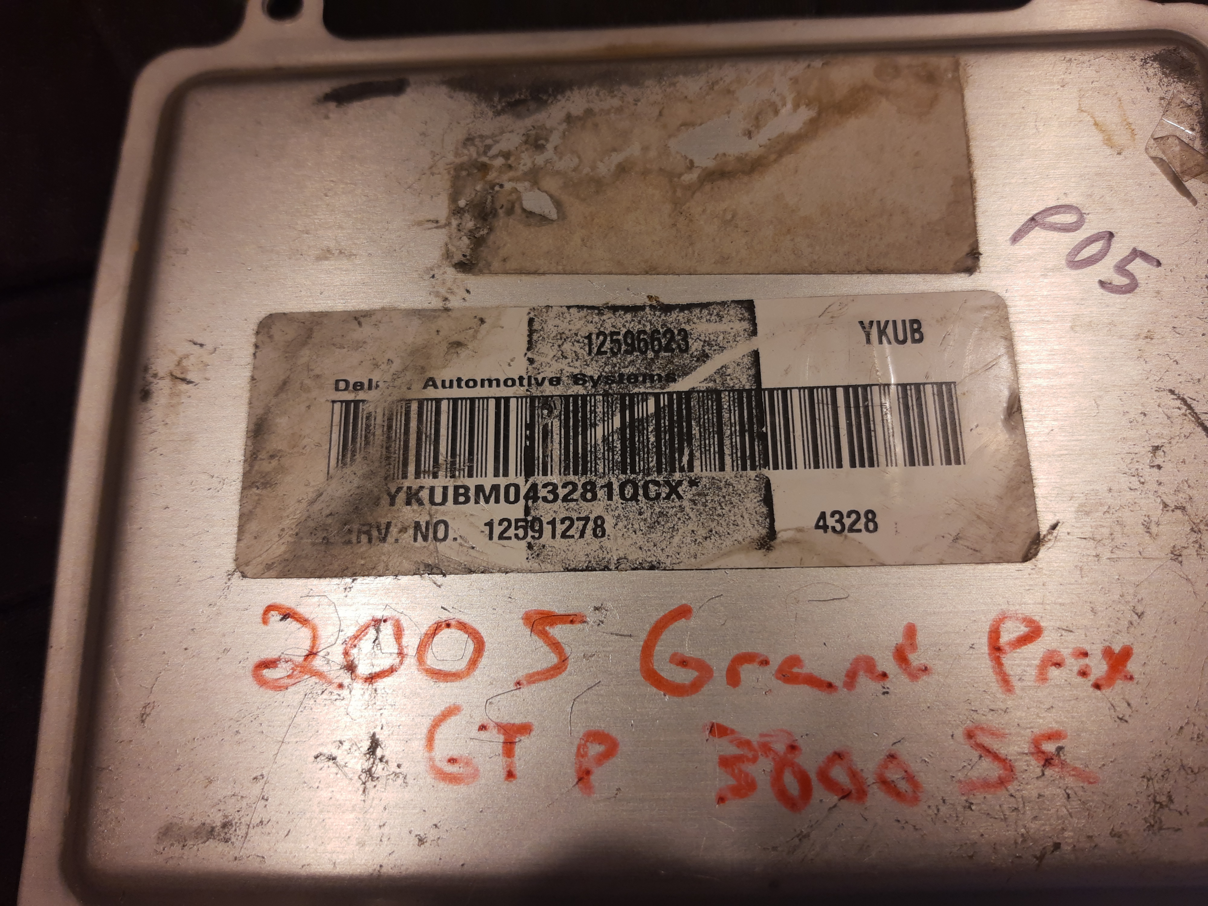

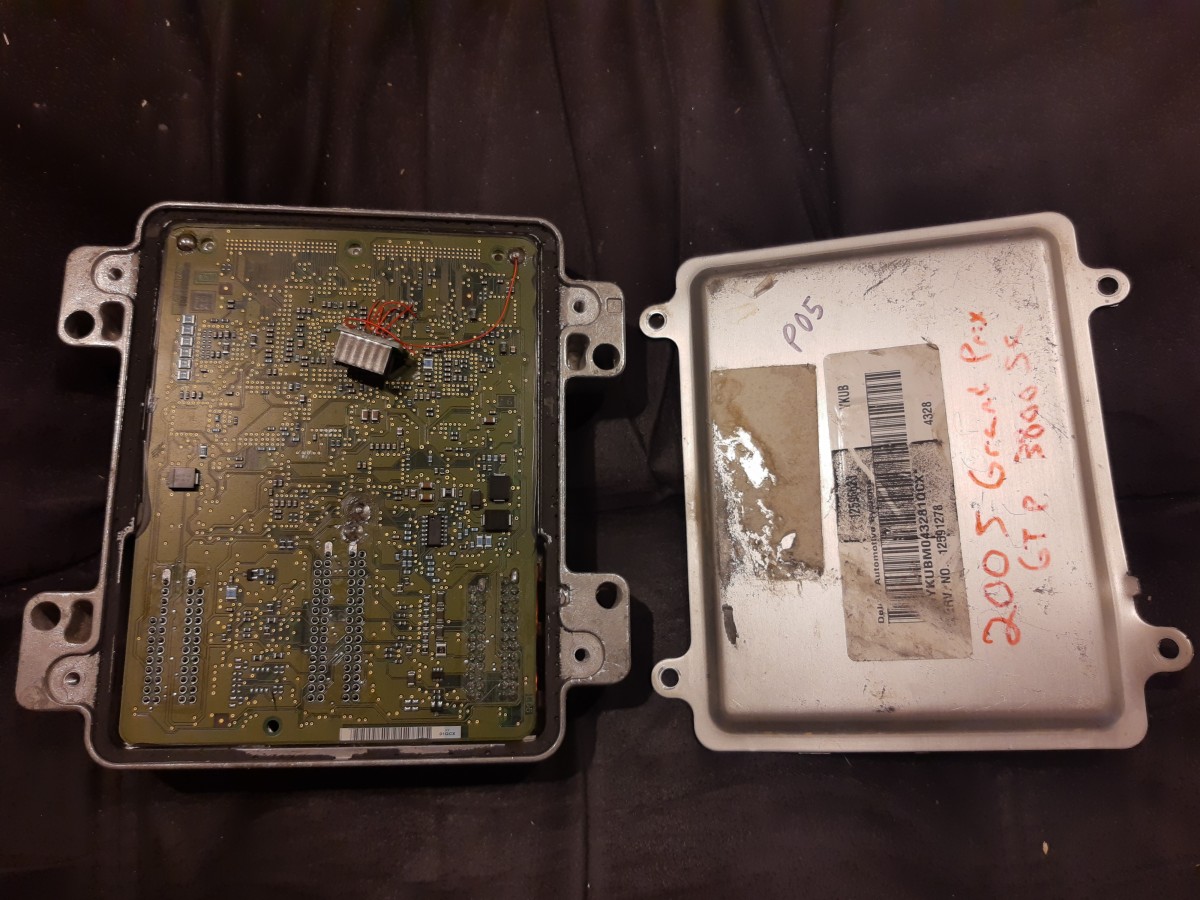

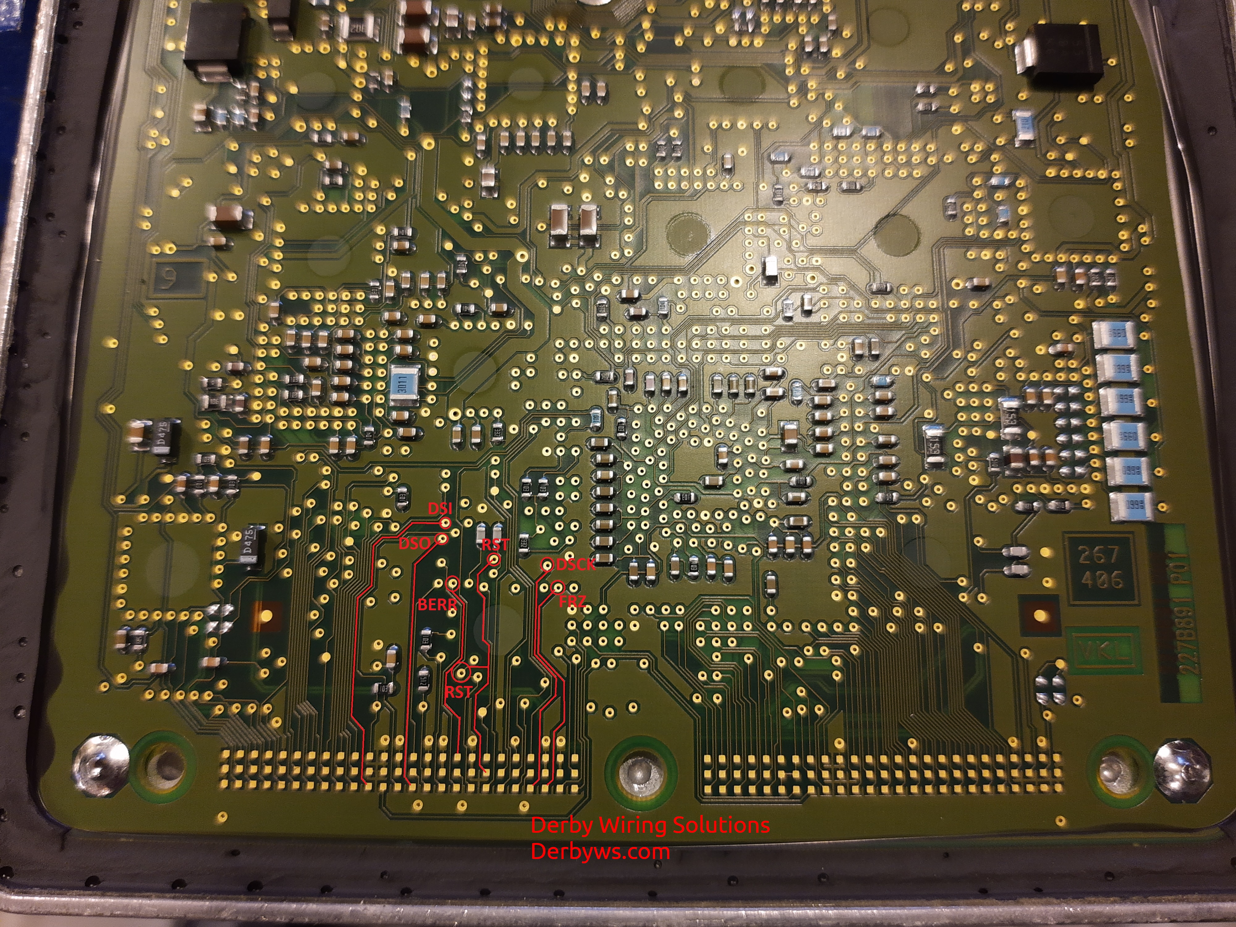

For the sake of being 100% accurate, here's actual photos of mine, the orig pic is from ebay. Looked at my notes, I guess I also have the BDM pins for P05 too lol. My notes says they are based on P11 locations and I have a bin file so the pins should work. I know I didn't get into them too deep, but looks like I was working with Ghidra a bit with the P05 bin a bit lol. I doubt I had much worked out though, maybe really simple things like coolant temp, air temp. Don't have that installed either, not sure if they have a Linux version, if not I'd probably have to setup a VM if/when I get back into these.

Gampy, as that ECM is for a 3.5l LZ4 THIS would be closer:
06+ Chevrolet Impala, Malibu, Monte Carlo / Pontiac G6 / Buick Lucerne / Saturn Aura 3.5 LZ4/LZE, 3.6 LY7, 3.9 LZ9/LZ8/LZD/LZG (E37/E38/E67 ECMs)
So No, I do NOT think it is a P05 though they are similar much like the P01, P04, P08 and P59 are similar.
Mike

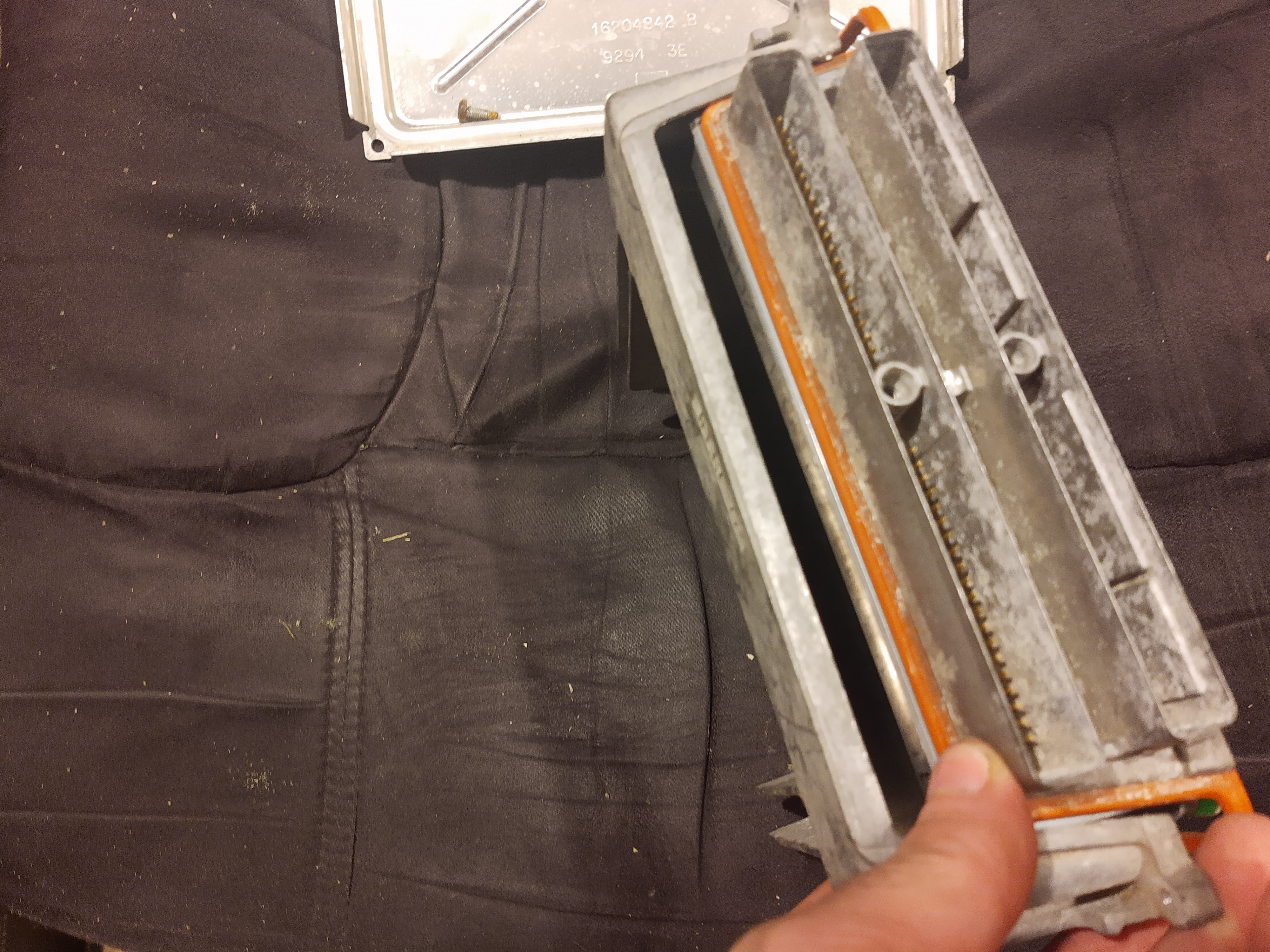

Nope, just pops right open for me. I've opened up around 8 or so P04's.
The P11's and P05's are glued together with a sort of thick silicone type of glue plus the actual connectors for the harness are soldered to the board and has to be desoldered to pull the board, but those are for a different car/engine.

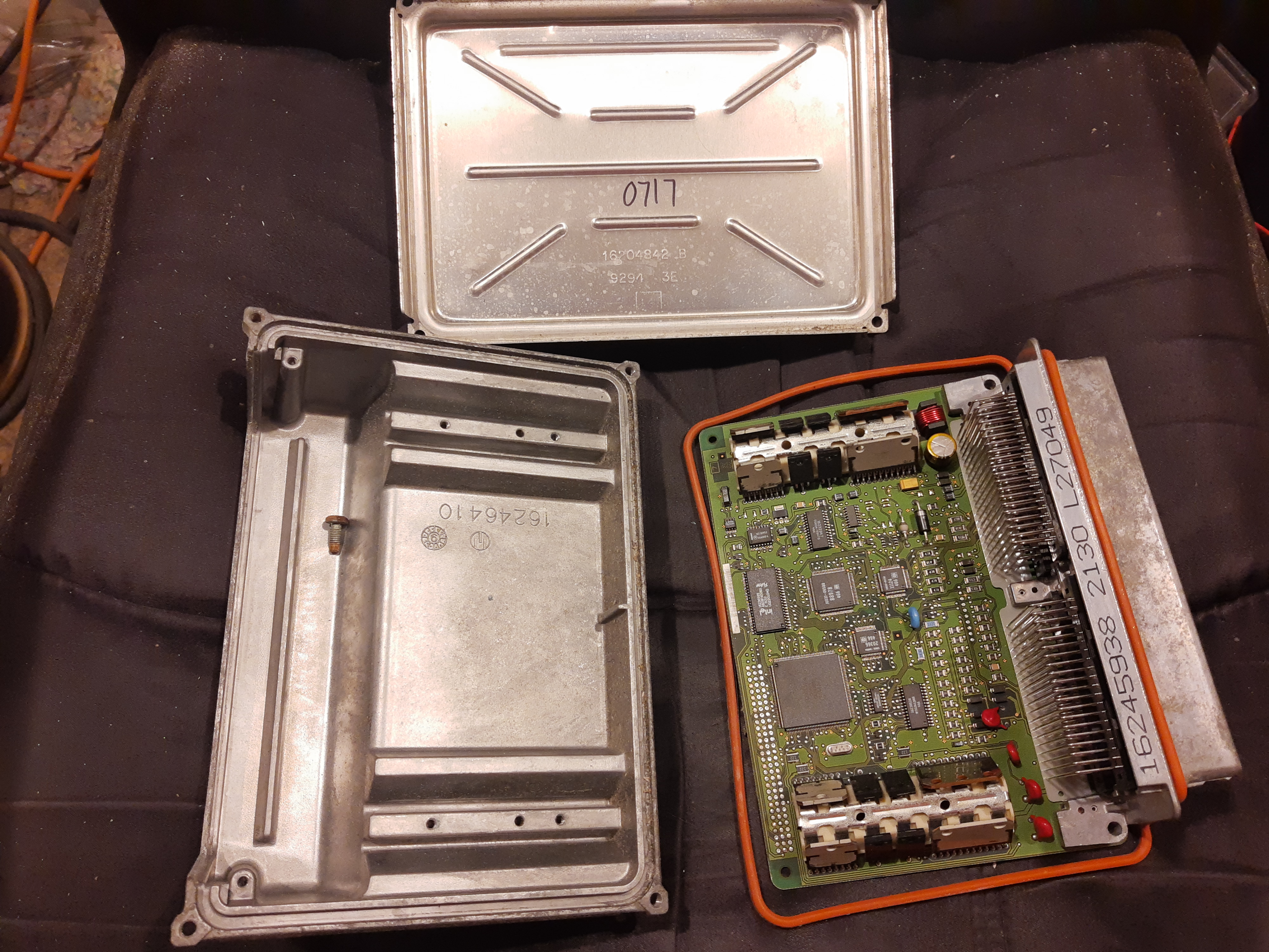

Here's a couple pics of a P04/P01/P59. Pretty sure it's a P04, I can see the Intel flash chip so probably from a W body, I got a hand full of failed W body flashed computers (bricked) that I wanted to try to recover. A lot of the hang up for pulling it apart is at the harness connector side.

DethRattles
Posts: 174
Joined: Wed Apr 05, 2023 11:38 am
cars: 2004 Grand am gt
Re: Bin Decoder (xdf file creater and more)
Post by DethRattles »
I see now ,,i was pulling down on the board slightly enough to get the borescope in...i got lucky then with seeing that amd chip with my borescope. One day i will learn,,,baby steps with clubbed feet :?
