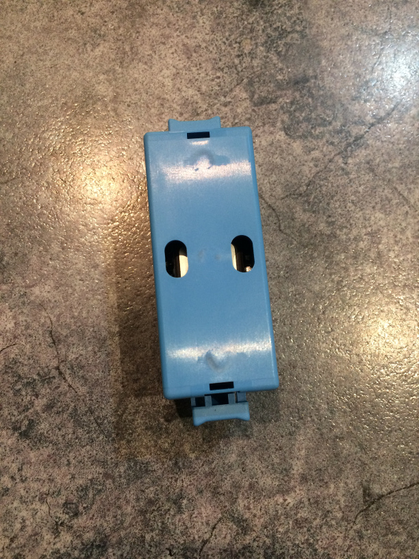

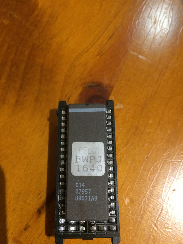

Re: Wannabe Tuna
Well I've had a chance to look at the memcals, neither one had a sticker on the blue cover. I pulled the covers off and the there are stickers on the memcals

Re: Wannabe Tuna
That doesn't look like it's been tampered with.
