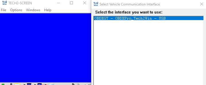

While working with DPDU, I have got it to the point that tech2win does display the OBDX in its tool selection box, but thats it for now. Not a fan of how DPDU runs, but... clearly someone though it should be done.
I have to have all the commands in place to then monitor what Tech2win calls to.. and make sure thats working before moving to the next one. The 1 by 1 approach seems to be more effective then trying to add everything at once, then having little mistakes that make it hard to know where it went wrong. Biggest problem is memory management, have to ensure the size of the variable is correct, and the SAE documents are very vague on describing what a long/int are in terms of size (32 bit or 64 ect).
Itll certainly be cool to see tech2win pulling up live data with it once its done though. I believe the OBDX VT is the cheapest tool on the planet to work with VPW on J2534 also now... soon to be DPDU!

have managed to go backwards with DPDU support somehow. I believe I actually had my initial connection screwed up, but tech2win just kinda ignored and proceeded forward.
After reimplementing everything correct, tech2win hangs up when it goes to show the initial tool selection/connection screen.. then crashes.
Its failing when it goes into the function:
PDUGetModuleIds(PDU_MODULE_ITEM **pModuleIdList)
The description of the parameter 'pModuleIdList' is:
Pointer for storing the pointer to Module Type Ids and the Module handles for all
modules that are connected to the D-PDU API. The data structure is described in
11.1.4.6.
The PDU_MODULE_ITEM structure setup is as follows:
typedef struct {
T_PDU_IT ItemType; /* value= PDU_IT_MODULE_ID */
UNUM32 NumEntries; /* number of entries written to the pModuleData array */
PDU_MODULE_DATA *pModuleData; /* pointer to array containing module types and module handles */
Now breaking this down... its a pointer... thats stores the pointer of the type PDU_MODULE_ITEM.
So things kinda like doing:
PDU_MODULE_ITEM MyCustomItem;
int* PointerForItem = MyCustomItem;
int* PointerforPointer = PointerForItem;
Or something really stupid like that... I think??

Post by Tazzi »
Dear old Murphies Law strikes again.
Just as I clicked submit... tech2win decides to display this...
The connection command above is using a pointer that then 'points' to another pointer.
What really screwed me over, was the internal pointer was just a random number, tech2win did not actually allocate any valid space to the value it entered as the internal pointer which was resulting in crashing the application when I tried to write the scantool data to it.
To resolve, I have made a brand new pointer which the required scantool data saved to the memory location, and then update the internal pointer address to the new address. :thumbup:
Absolutely stupid way of doing things.. but.. we are 3 commands down of a potential 29.
