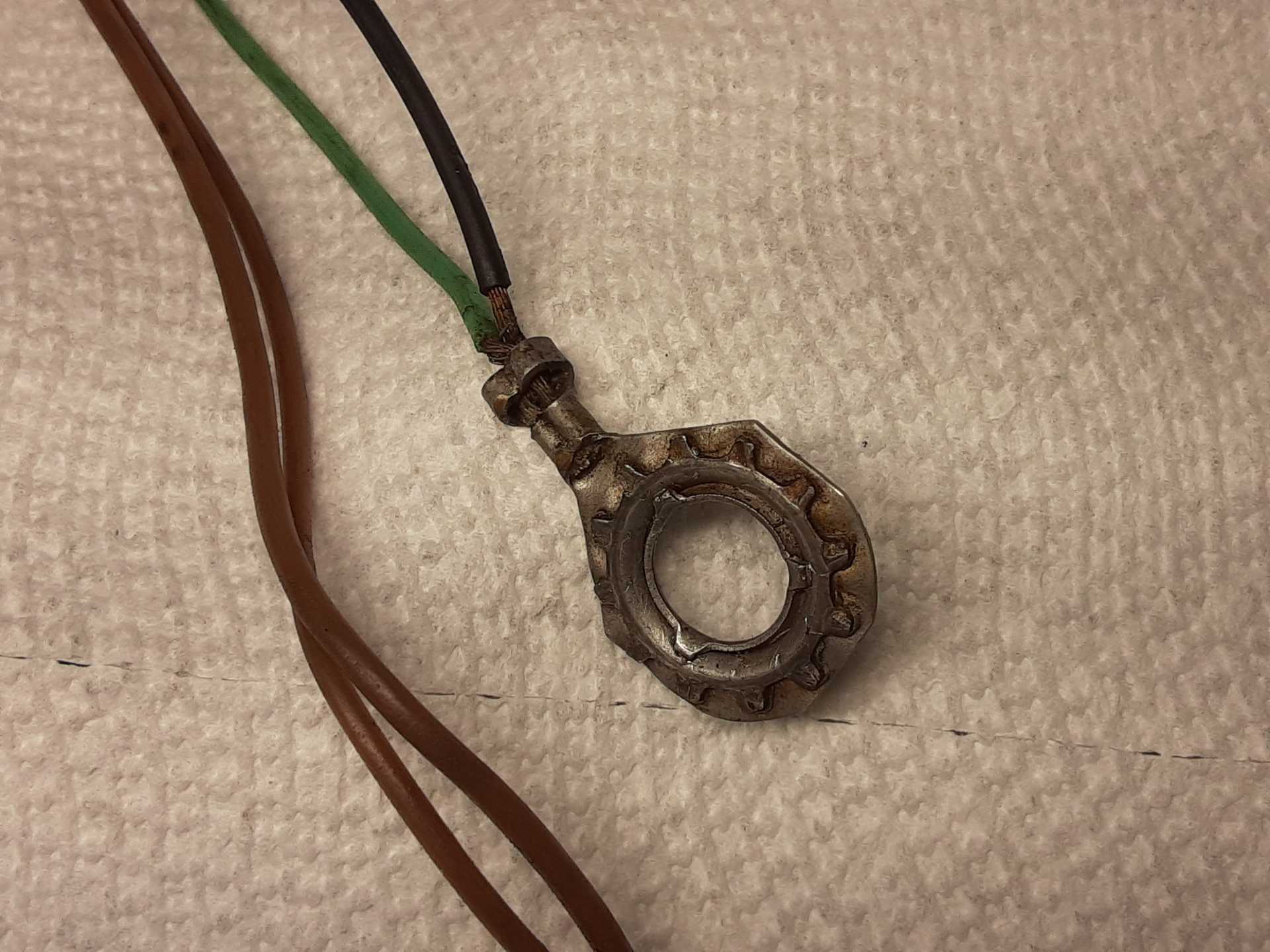

While investigating today, the only "iffy" thing I can find that may be an intermittent is this.
The Black wire is a ground directly from D1 of the ECM.
Looks like it's been stretched and the wire could also be internally frayed?

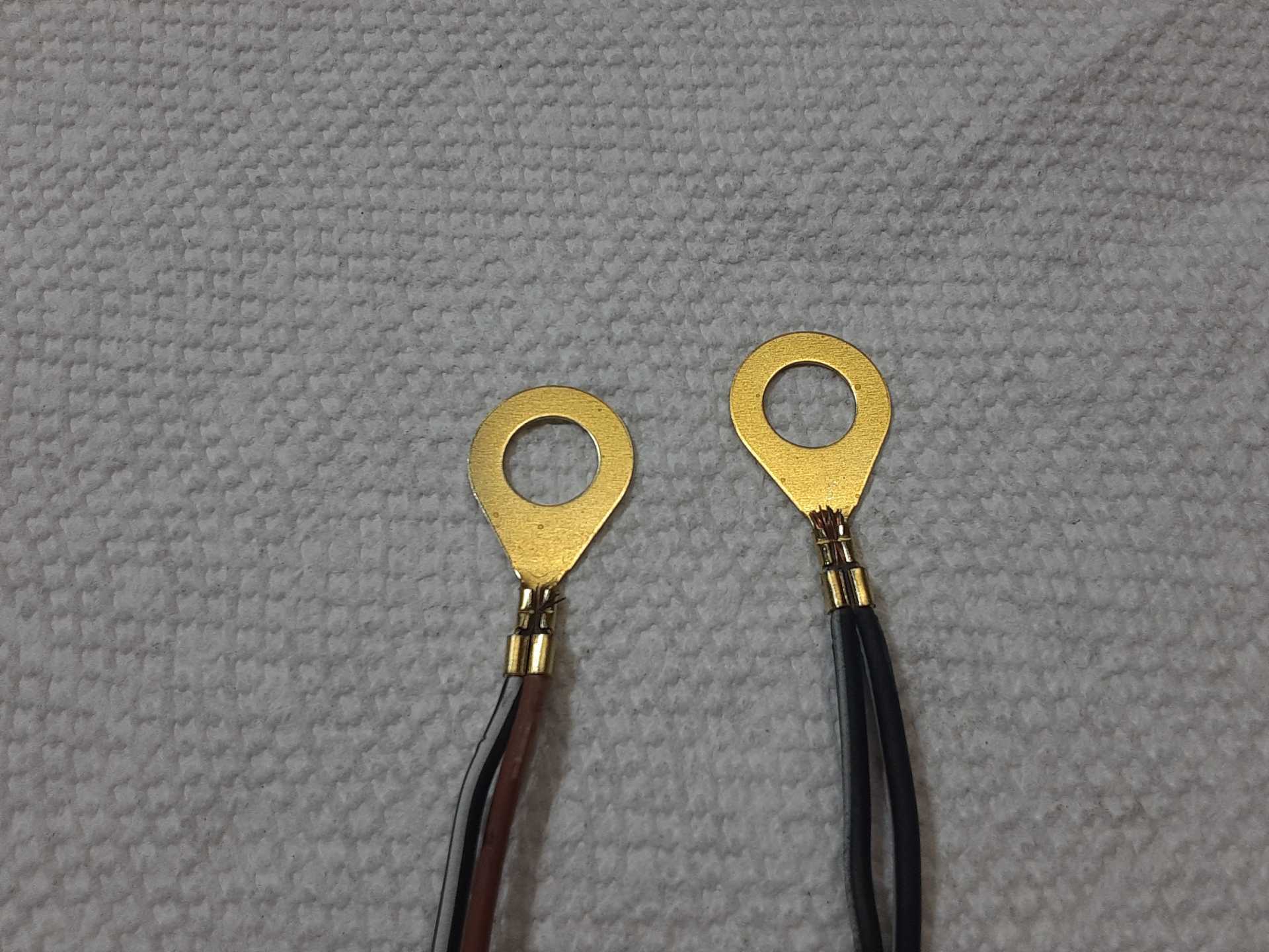

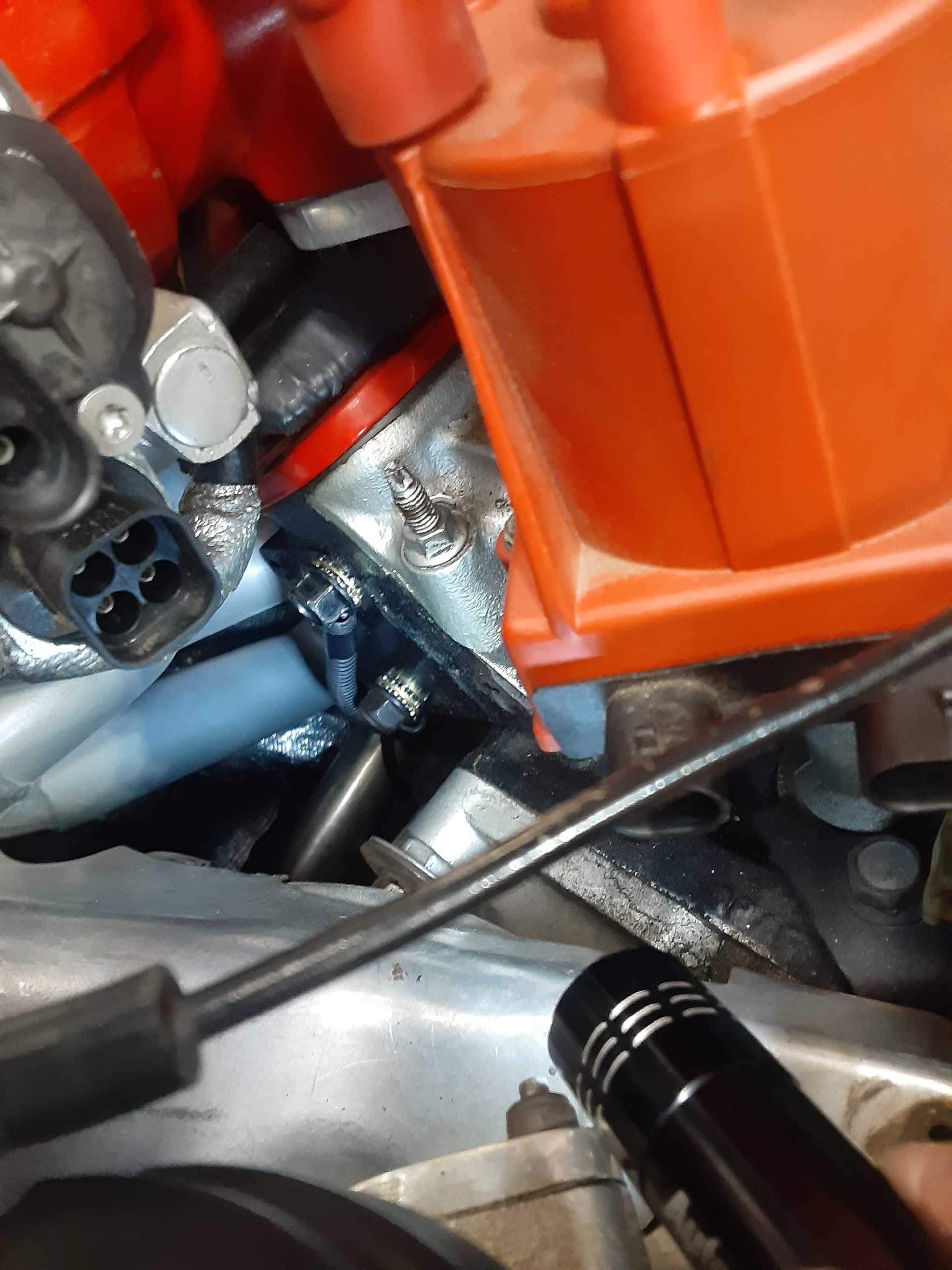

Progress. Made new pigtails that I crimped/soldered to the harness.
It was when I was bolting them back to the head, that I discovered one bolt was longer than the other.
This mixup may have happened when I last had things apart to replace the clutch.
I measured the hole depth, and yes, it is possible the bolt was bottoming in the threads.
(this may have been the problem all along - bolt is "tight" but not actually clamping wiring eyelets solidly to head)
I replaced it with a 1/4" shorter bolt to match the other and used star washers.
So far, the car has been driving fine. ECM is not complaining about a "bad ground".
As I mentioned before, the CEL problem and Code 55 was very random.
(2 of the 4 wires are grounds directly to the ECMs internals)
Been driving around for almost a week now. NO ISSUES.
I think the problem has been solved. <fingers crossed>
I'd have discovered this sooner had I removed both ground bolts, instead of just tightening.
Since they were "tight" I was convinced the grounding was good. It wasn't on the long bolt.
