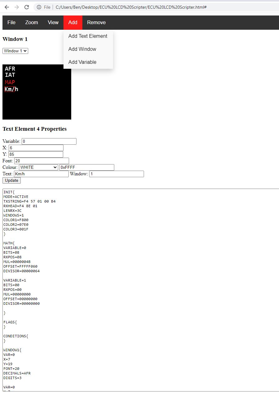

Is this logical enough for the config file? Could it be done better?
INIT{
	MODE=ACTIVE
	TXSTRING=F4 57 01 00 B4
	RXHEAD=F4 8E 01
	RXLEN=3C
	CHECKSUM=YES
	WINDOWS=3
	COLOR1=BLUE
	COLOR2=GREEN
	COLOR3=RED
MATH{
	;EG COOLANT TEMP - WE'LL USE VARIABLE 0 FOR CLT
	;			CLT=RXbyteArray[8];
	;			longCLT=(CLT * 75)-4000;
	;			CLT=longCLT/100;
	; var#=bits,RXpos,mul,offset,divisor,decimals,digits,color threshold 1, CT2, CT3
	VARIABLE=0
	BITS=8
	RXPOS=8
	MUL=75
	OFFSET=-4000
	DIVISOR=100
	DECIMALS=0
	DIGITS=3
	CT1=0
	CT2=70
	CT3=110
	;	Ign timing advance
	;	SPK=(RXbyteArray[34]<<8 )| RXbyteArray[35] ;
	;	longSPK=SPK * 351565;
	;	SPK=longSPK / 100000;
	VARIABLE=1
	BITS=16
	RXPOS=34
	MUL=351565
	OFFSET=0
	DIVISOR=100000
	DECIMALS=1
	DIGITS=3
	CT1=0
	CT2=0
	CT3=90
FLAGS{
	;Priority; 1=important, overwrite screen with flag text, 0=not important, only displayed if defined in the window setup
	FLAG=0
	PRIORITY=1
	OFFSET=2B
	MASK=80
	FALSE=""
	TRUE="DTC48 HIGH BOOST"
	FLAG=1
	PRIORITY=1
	OFFSET=2B
	MASK=20
	FALSE=""
	TRUE="DTC51 MEMCAL ERR"
	FLAG=2
	PRIORITY=0
	OFFSET=2C
	MASK=02
	FALSE="OPEN LOOP"
	TRUE="CLOSED LOOP"
CONDITIONS{  ;When to show which windows
	WINDOW1
	WINDOW2=VAR0>20
	WINDOW3=VAR1>50
WINDOW1{
	VAR=0
	X=0
	Y=0
	FONT=0
	VAR=1
	X=0
	Y=40
	FONT=1
	FLAG=2
	X=0
	Y=60
	FONT=0
WINDOW2{
	BMP=NO
	VAR=0
	X=0
	Y=0
	FONT=0
	VAR=1
	X=0
	Y=40
	FONT=1
WINDOW3{
	BMP=NO
	TEXTxyf="CLT",20,20,0
	TEXTxyf="ADVANCE",20,50,0
	VAR=0
	X=0
	Y=0
	FONT=0
	VAR=1
	X=0
	Y=40
	FONT=1

An app my brother is working on to make the display a kind of drag and drop setup. Still early days on that side but the text scripting is just about finalised so if you can wrap your head around the config file format you should be able to create any layout you can think of.
I'll add in firmware update over SD card to make any firmware changes super easy to manage.
