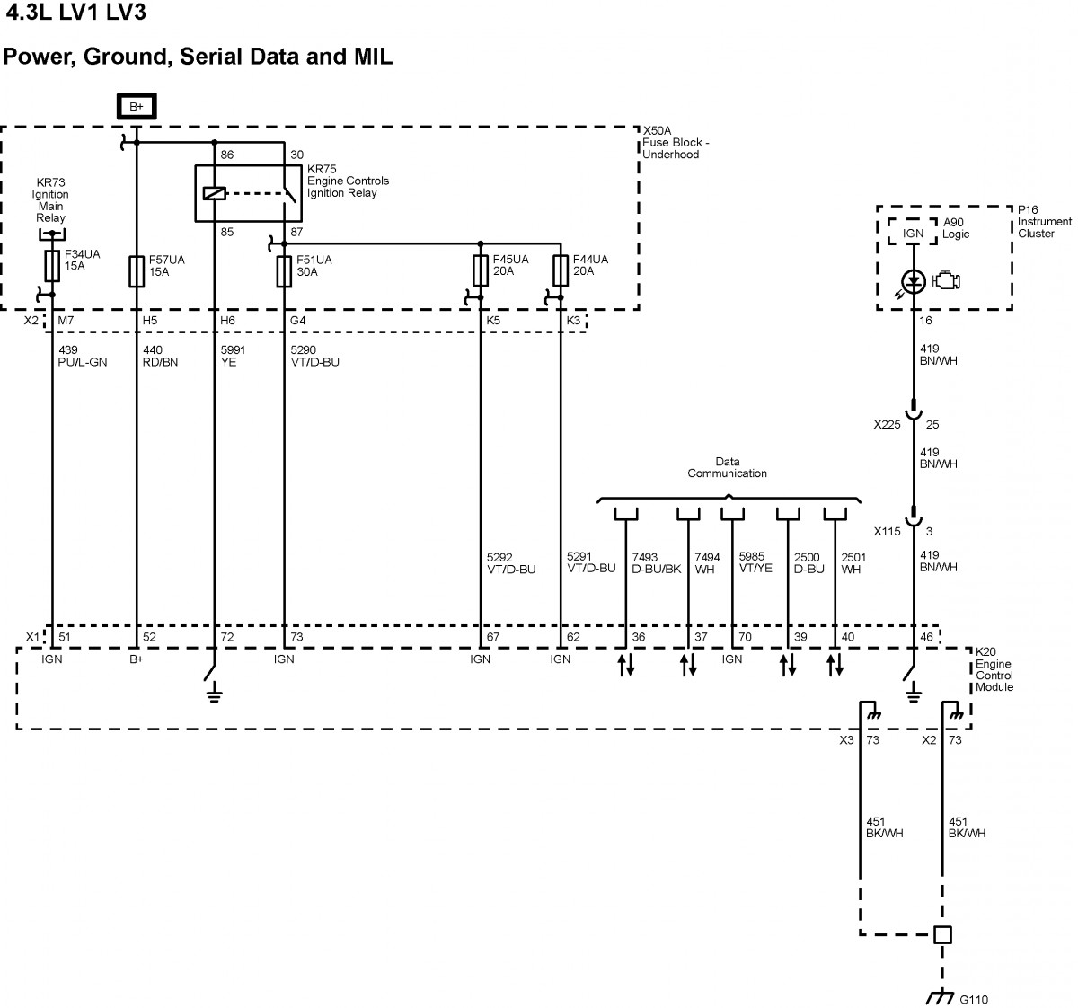

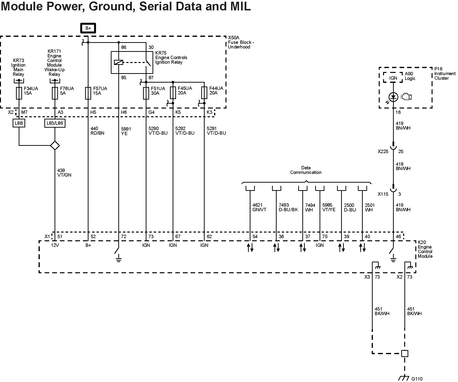

I'm not sure how much I trust that pinout. I'm seeing a lot of different information with respect to pinouts.
Attached is what I've found via a online resource from my local library.
Edit: I also found this post on another forum (2014 L83 5.3 Direct Injection E92 ECM Pin Outs).
2016 Silverado 1500 4.3L V6
2018 Silverado 1500 5.3L V8

The pin numbers in the PDF are wrong, but the terminal assignments match up with the AllData diagrams for my Corvette, and they diagrams you linked.
