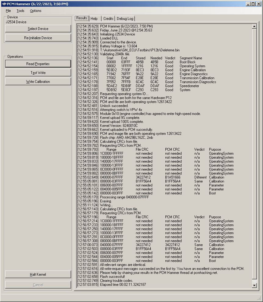

Not to slam the door on your face or anything like that, however the PCM Hammer suite already supports reading the P04, and has for awhile, code is in the Github repo.
As for writing to the P04, this is what I'll say to that, I'm close, real close ... Here is an example of how close. That's the new "Assembly Kernel" writing to the last target in PCM Hammers C Kernel 'Supported' write list (P01/P59, P10, P12, P12b).
The C Kernels are now superseded!
Next target ... Drum roll ... P04!
However right at this moment they are getting a rigorous beating wasting write cycles on the current PCMs ... Over and Over and Over and Over!
I should know within a few hours what it is going to take to write to the P04, I suspect I'll be trying shortly.

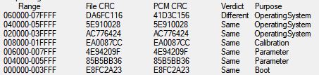

So for now with the current P04 kernel, erase and write don't work. Is there documentation how I can build on top of the existing kernels?
All of my changes to the bin were made in the OS sector. Antus, if you remember, I was working without the CRC, I didn't realize how CRC part worked.
- Posts: 10111
Re: PCMHammer P04
Gampy has a private branch at the moment. I dont think there is much to add for now, it could be a too many cooks situation. There are no unknowns and it just needs some minor updates for more platforms and more testing. Common code is done. I have helped fix a bug in AMD erase, but now I am out also and just waiting. Erase and write is working for both intel and amd chip. Now its just a case of putting the configuration part in for the other platforms and testing. I expect he'll ask for beta testers soonish and we can jump back in then. The app does still need some more work on OSID databases, but I think P04 is good.
