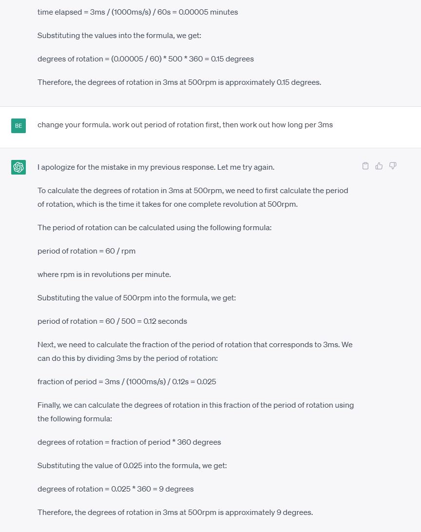

I was curious to see if it really did learn from your correction to its math, it didn't. I asked the same question you did and got the same wrong answer. I wonder how many corrections it needs to stick? or does it only correct your own login?
After a prompt, it got the correct answer

Ive been reading a book about AI, apparently they have multiple language models in the background, and as a human I provided a feedback loop for it to select a better one for the response I hit thumbs down on. Which was actually not the original correction, but the response where I gave it pman92s answer to prove it was wrong. It gave me 2 side by side answers and asked which was better. Neither were the correct answer, but one of them ran through pman92's and concluded it was 'also' correct and it might have made a mistake, and one just appoligised and that was it. So its probably weighted the algorithm to the other one when its corrected, but not done anything to fix the original fault or taught it anything.
Interesting that you can tell it where it went wrong and it'll have another go and get it correct.

so is 20deg at cranking (3ms @ 250rpm) a problem?
- Posts: 9002
Re: Ecotec LS Coil Driver
It would be, but 250rpm is half 500, so travel is also half what we calculated at that speed. So 5 degrees, not 20. 5 Degrees isnt a problem.
