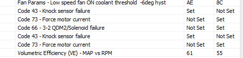

these are all the codes i've changed in the bedford tune, its a vn motor and auto box, and i just re-wired to use $11P ....
auto codes.jpg (37.88 KiB) Viewed 3819 times
Re: How to loose 200kgs?....
We should another code called 11M a manual version were all auto stuff is removed and new inputs/outputs are made available for other uses lol
