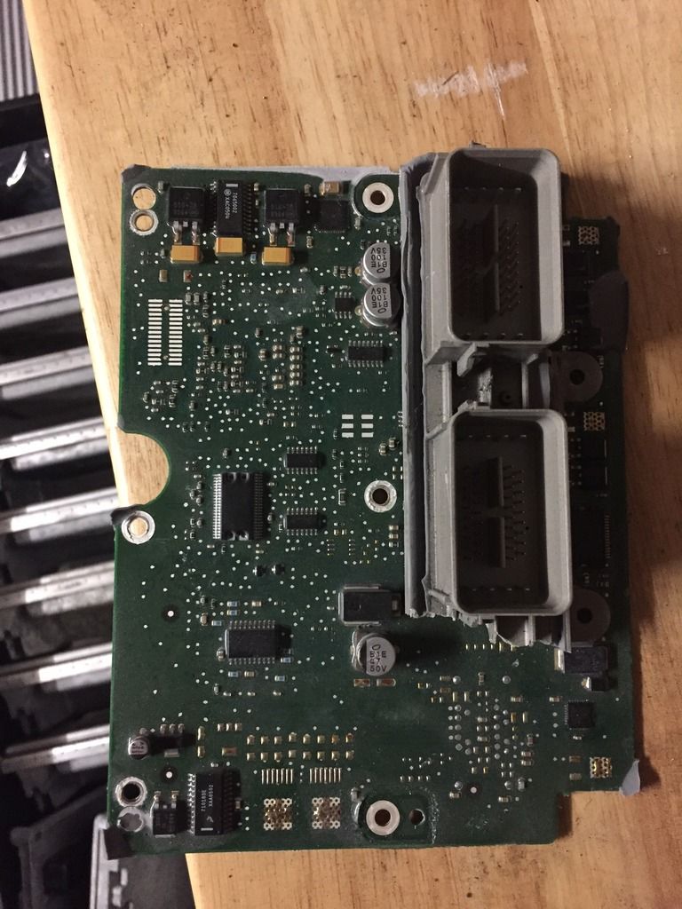

rolls wrote:In case anyone was wondering this is how you remove the case on your PCM. FYI it is not going back on once you take it off lol. Bent the fuck out of it with a screwdriver. I think if you used a heat gun you could possibly melt the high temp glue off and remove it with a knife without damaging it if you were so inclined.
heh.. you have more patience than I do.. I used a small angle grinder. wasn't expecting it to ever go back on.
that ecu looks familiar!!
Heres a 2 plug i open some time ago, i used a angle grinder tho, board construction looks the similar just missing some components
