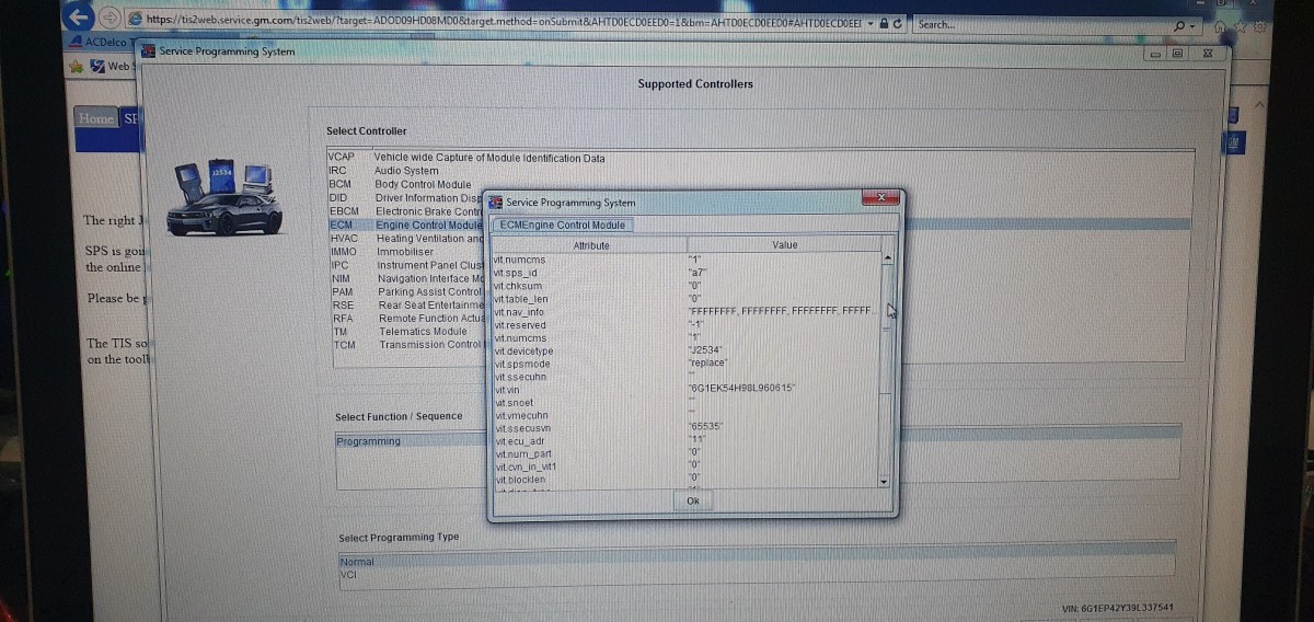

This is the log from the one I can't get in to. Out of all the bricks I had, this would have been the easiest but so far I've had no luck.
It's definitely not tunerlocked. It was flashed wrong and brought back to life with SPS(Vauxhall/LS2/LS3), but I think that's what scrambled it in the first place. I can load this one up in my paid SPS account and get it to want to start programming with a Holden VIN but choosing Chev out of the drop down list, but it fails. Reprogramming Error E4491 and E4423 - unknown reprogramming error 5 at step 0.
The Vauxhall SPS brought back one of the the other 2 I have earlier today but scrambled the vin and serial number - Tazzi's flasher has now restored that with my 2010 bin file.

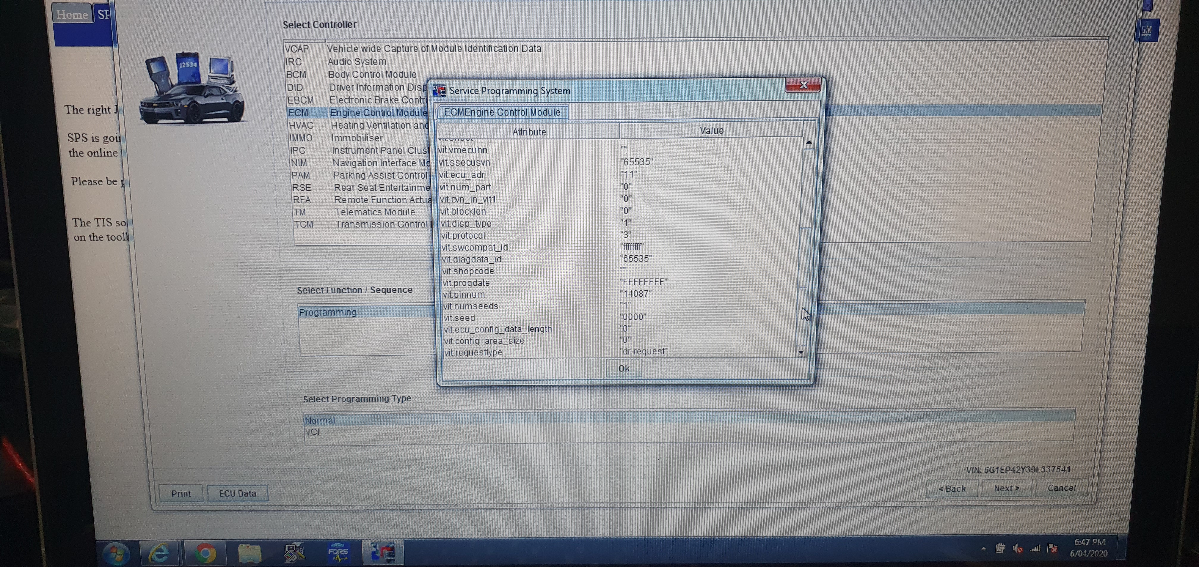

Re: GM E38 E67 Kernel/Bootloader Development Extravaganza
oh, must be a recovery seed/key then maybe?? Wonder what the keys is...
shows as 0x1000... yet SPS says its 0000..
Wonder if the key is 0xEFFF.
Glad its working well for you!!!
Works for my bench unit at work!!! Can't wait to get home and try the problematic one.. Nice!! Love how it came up with the save file name for me, excellent..
Looks like the ecu is in recovery but it had 1000 for a seed?? Weird how Tazzi's program comes up with the 0x1000 for seed and gmsps says it's 0000... I'm assuming his program looks to see if it's in recovery?? I thought that was when the seed is 0000 but its already unlocked?
Can you try a tuner lock key of 0000??? or even try 1000...
1000 worked. F me. Awesome!!!
