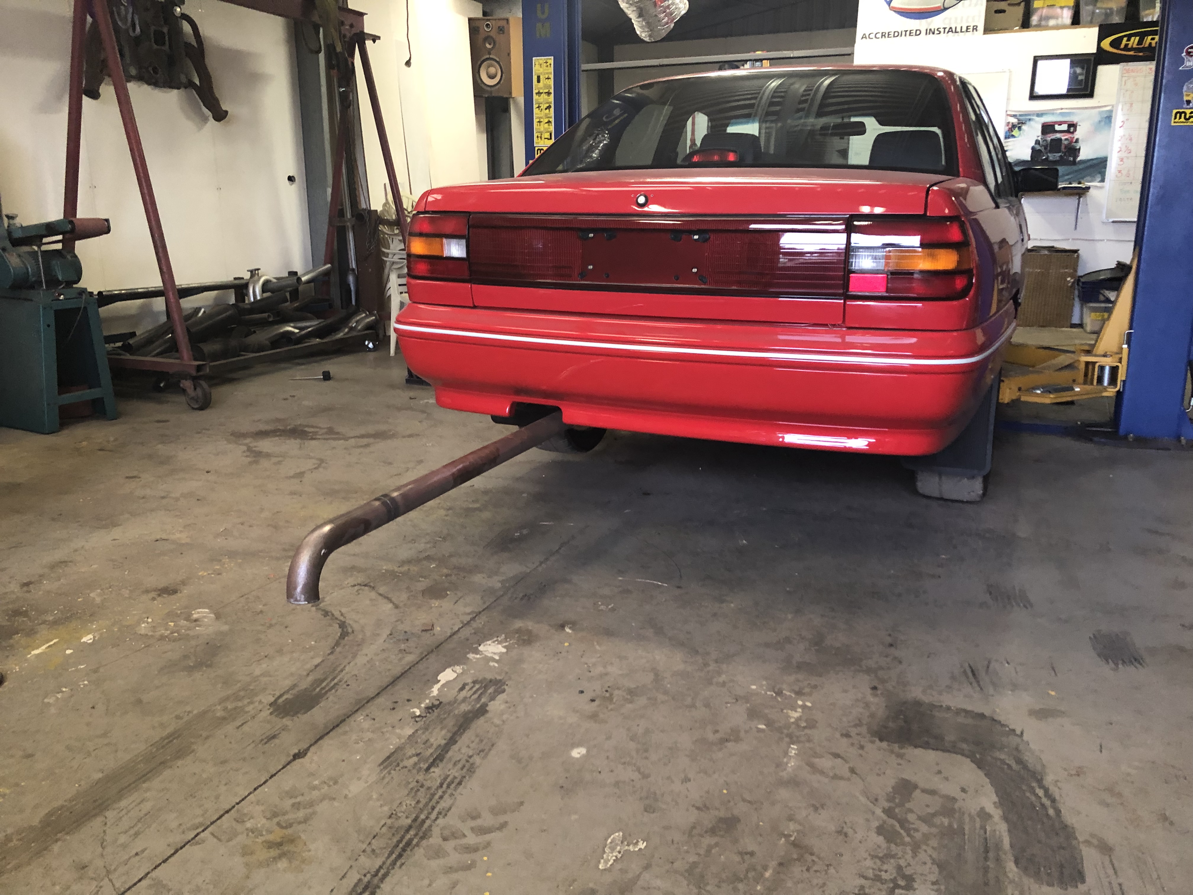

Vlad that exhaust note is what I am after with my V6, sounds great.
Can you run through what size piping &, mufflers etc etc the system has ? Is it twin system all the way without a crossover or balance pipe ?
yeah atm it's twin all the way with no cross over but I am having it changed to merge into a 2.5" single just before the diff to fix clearance issues. It has twin cats and mufflers.
It will have a rear resonator added to the single pipe section as part of the change as it was way too loud and barky in 3rd gear. Still going to have twin tips though.

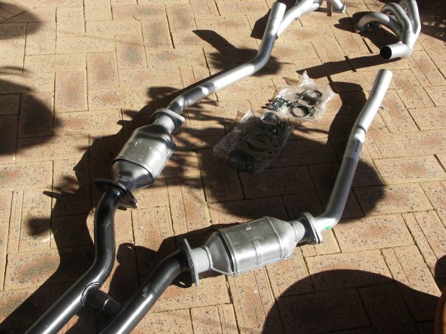

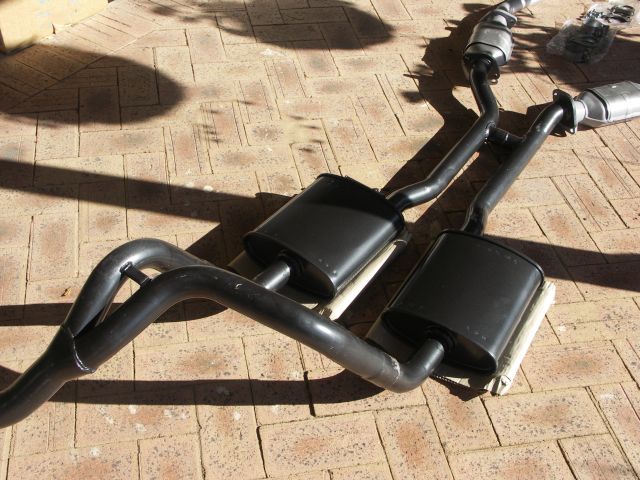

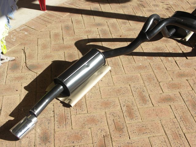

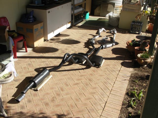

We fitted a system a little like your chasing now to a VR Ute with Super6. It was a sports system made by Perry Exhaust to suit a 5 litre. Twin 2.5" metal cats into a twin 2.1/4" pipe through two 2.1/4" mufflers & then collected into a single 2.5" over the diff & a single 2.5" rear resonator. Gave a good note (not loud) with no drone & very little restriction. When trying to get another a few years later they no longer made it. Plus now Perry are also no longer.
This is probably similiar to what your after.

My mufflers are about half that size and resonator a tiny bit smaller too but yes similar to that is where it's heading. I think the cross over doesn't help with performance or sound on a V6 since they have already even firing order.

Love the new exhaust tip :thumbup:
