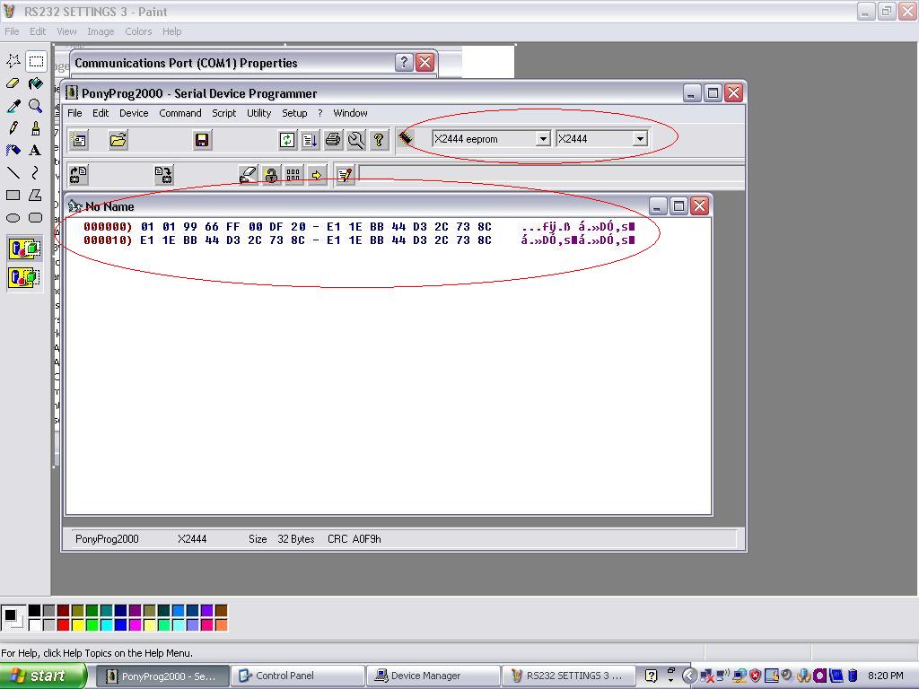

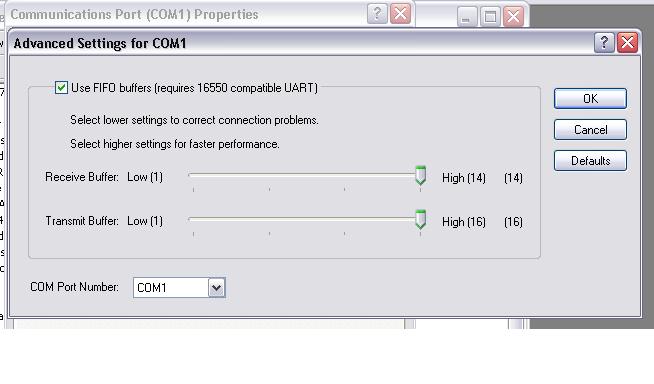

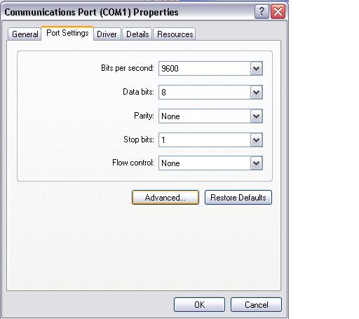

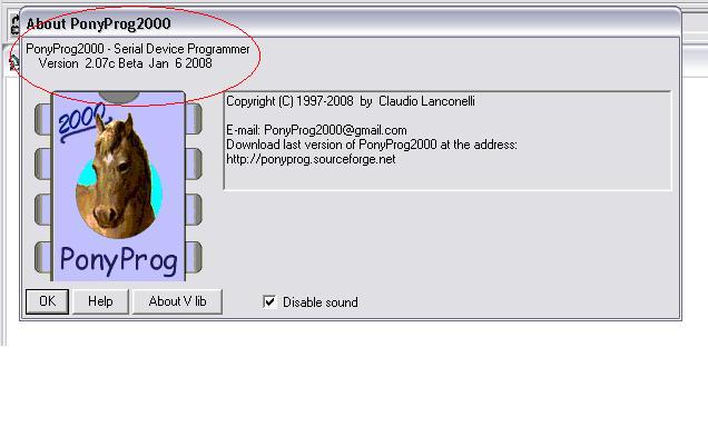

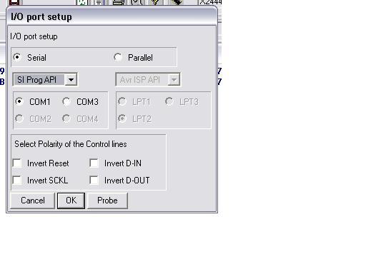

Hi Guys,
I am going insane getting this going.
I’ll start from the start.
Fresh Windows XP install on my Toshiba A3 with Built in serial port
Fresh install of Ponyprog Settings of PonyProg
XP Serial Settings: XP UART Settings:
XP Drivers Serial Info
Wiring goes like:
The ICSP header on the programmer has pins 1-10
So chip to programmer
1-3
2-4
3-5
4-6
5 - 10
6,7,8 (joined) – 1
Made sure 16bit selected , and x2444 jumper is off.
After all this hard work bellow is the info I get when I read the chip….
PLEASE HELP…..

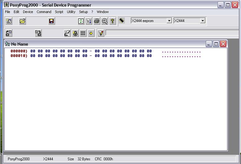

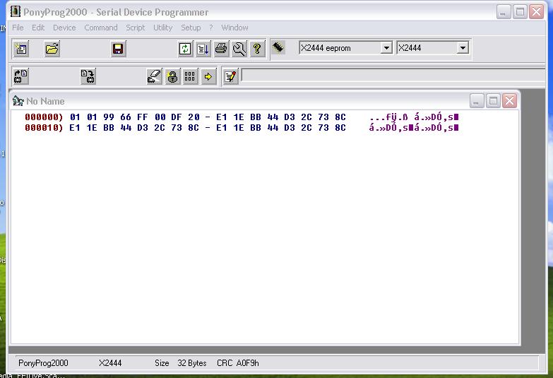

Hi Guys,
Have notice a different read between chip in and out but cannot do anything with it ie write.
Chip out Chip in Thanks for any assistance

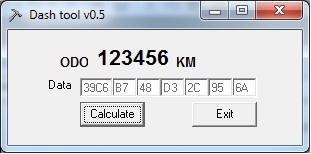

Here's a quick and dirty calculator, just enter the desired odo reading at the top and it calculates the digits, checksums and block checksum, and does the endian conversion for you too.
I haven't tested it much but it looks like it calculates the right hex values for the couple of odo readings I've tried with it.
I was hoping to do it with an xdf for the dash bins, but couldn't work out a way to do the maths with TP so this is the best I could think of without spening too much time on it.

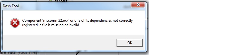

Hi Mate,festy wrote:Here's a quick and dirty calculator, just enter the desired odo reading at the top and it calculates the digits, checksums and block checksum, and does the endian conversion for you too.
When i run i get this error on all 3 of my machines ( XP, VISTA & WIN 7) any ideas?
Thanks
Daniel
