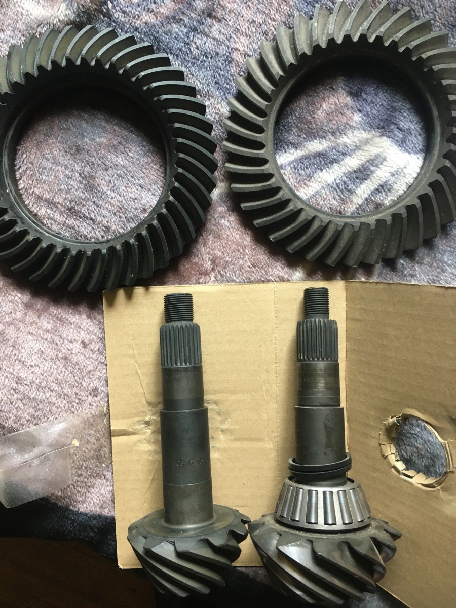

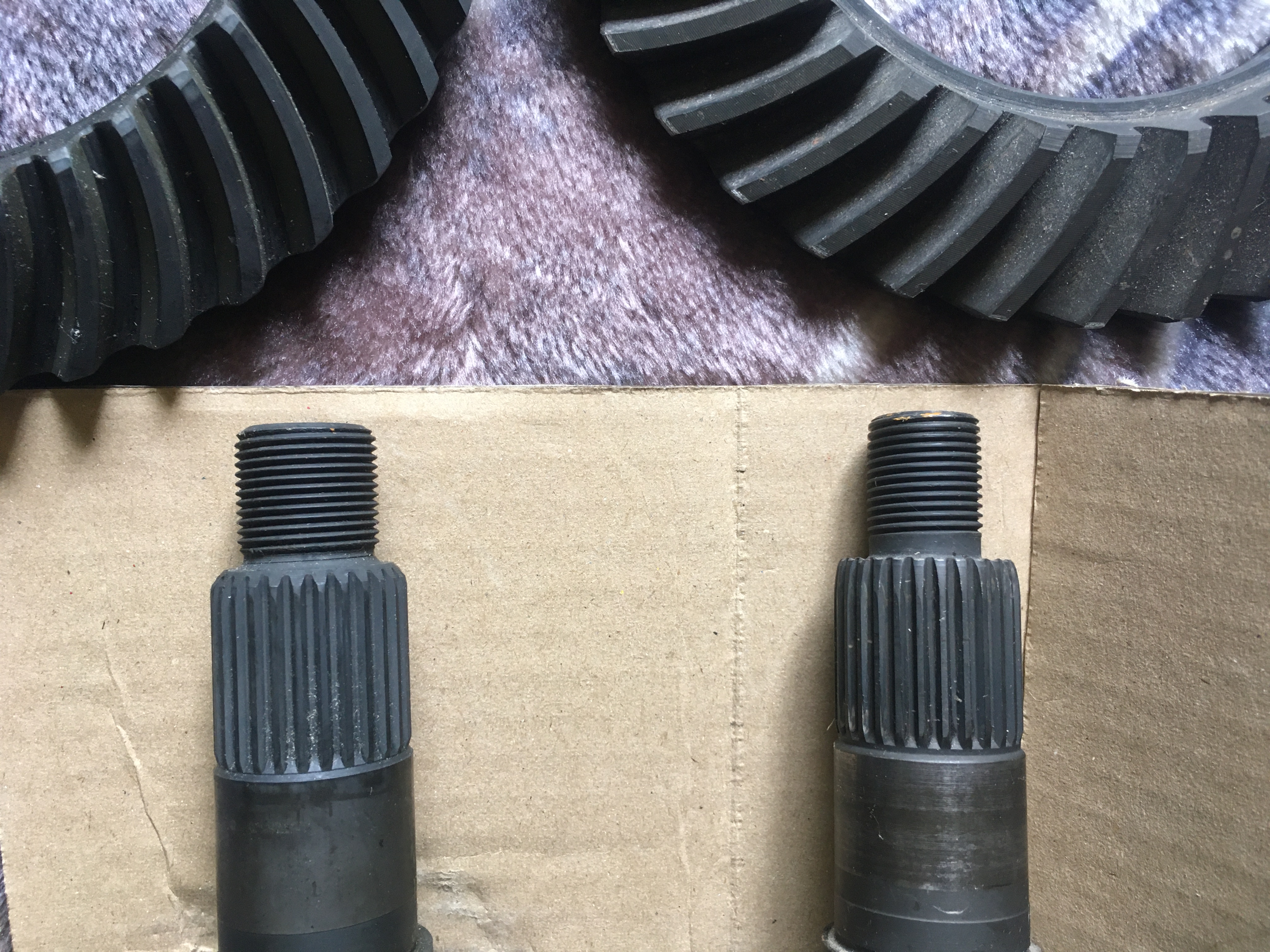

Interesting how they changed the thread size, its mentioned in the included paper. New gears left, some old 3.08 ones right for comparison.
- Posts: 8124
Well I managed to get a new nut to suit but its way too wide to fit into the diff flange. The flanged part of the nut is quite wide while the nut itself is 30mm. It is 42mm at the flange while the original one is 36mm. Good news is after machining it to 36mm it will fit inside and a 30mm socket can still reach deep enough to do it up.

The diff rebuild kit I got to do my M80 came with 2 new nuts of different sizes.

As for the diff nuts, turns out I bought the wrong one that was stated in the instructions. The nuts flange was too big to fit in the diff flange. Turned out to be another part number to suit the same M22 but with small flange to suit older M75 so I got that and it fits now.

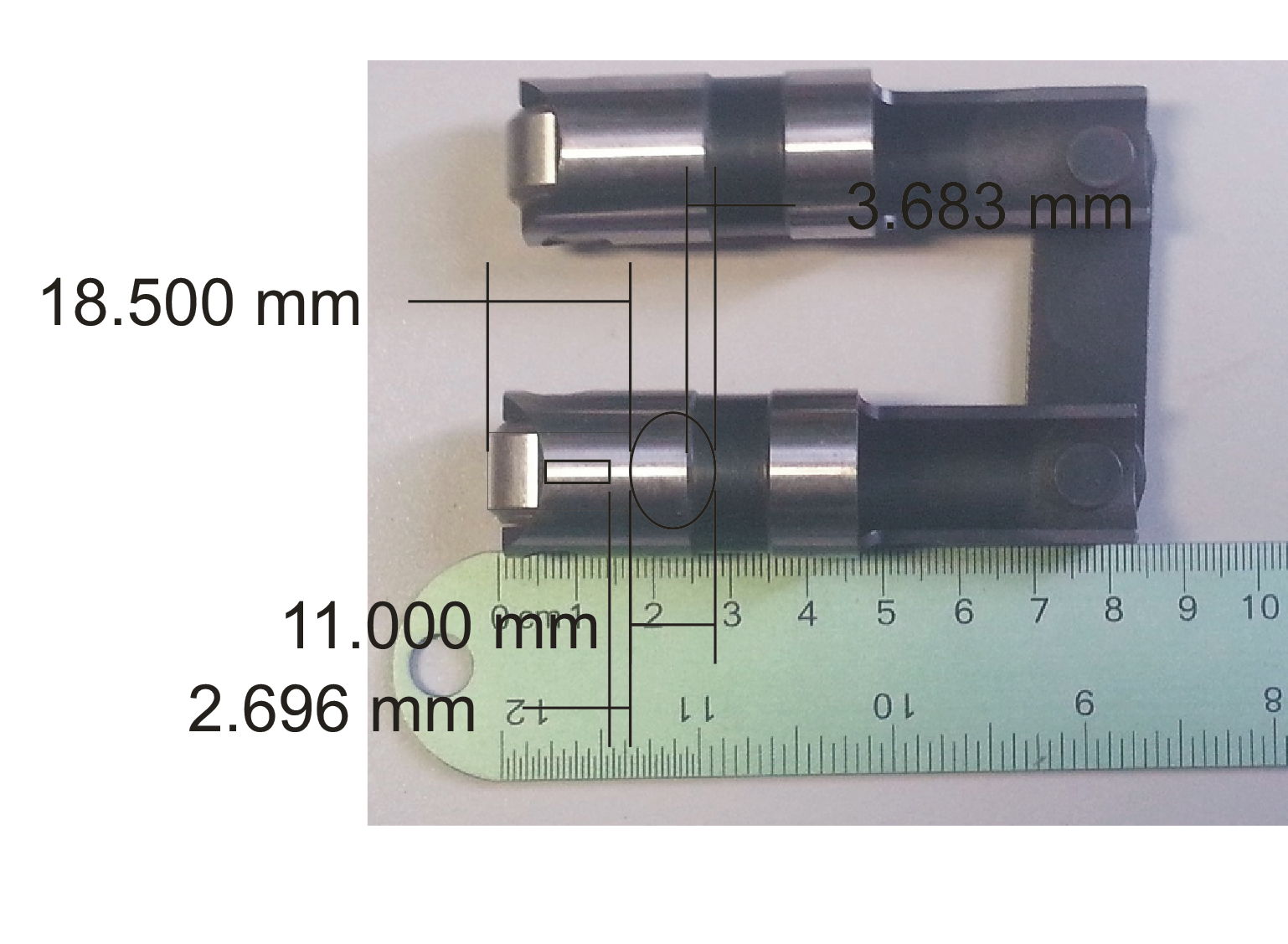

So I have been dealing with an agent for Johnson lifters, same buick expert I talked to few years back and from my measurements they should just work but close call. They are slightly un-shrouded so it gets to 2.7mm of the oil galley on my cam of choice based on the stock base circle, though my cam will have a smaller circle so it will be better than 2.7mm.
They can also do the custom tie bars no problem. So the plan is to get one pair as a sample to double check the measurements before going ahead with everything.
Here is a pic of the measurements. Oval is the oil galley, 11mm wide and the bottom edge is 18.5mm from the base circle. The small rectangle is the lift distance traveled by the shroud upper edge from 0 lift to full lift relative to the gallery, in my case 328 thou lobe lift.
That clears by 2.7mm so it shouldn't bleed much oil, and the oil gallery is exposed to the lifter collar by 3.68mm at a min which also should be enough oil supply, will be more with the smaller base circle.
I am confirming with Clive cams the base circle size for that cam profile and will report back once I know and have calculated the true values.

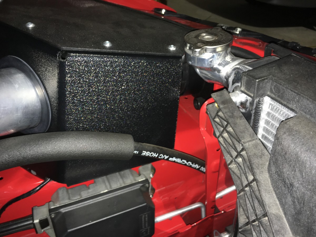

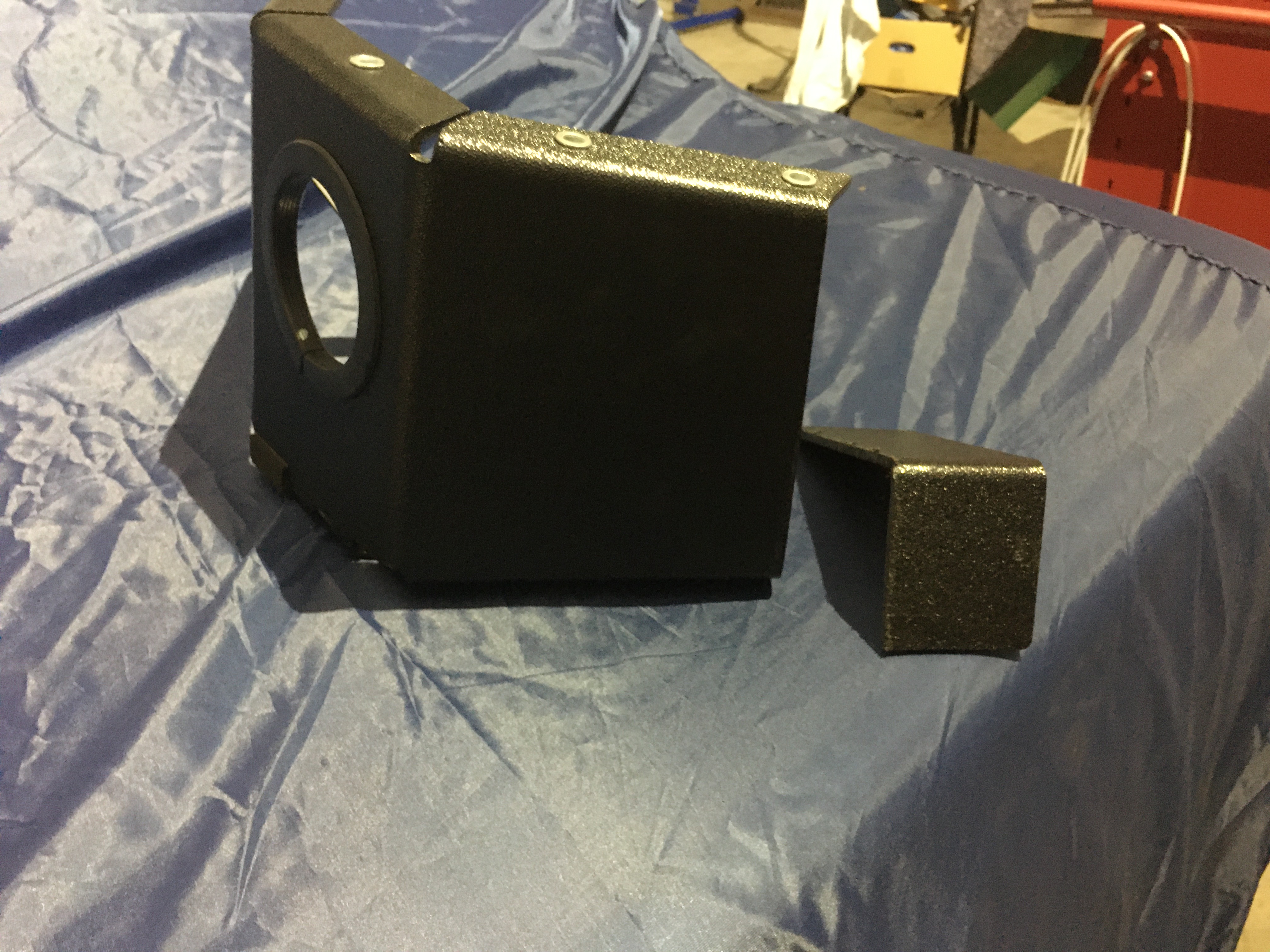

Decided to finally mod (some more) the mace CAI to fix the restriction once and for all and finally be able to put the lid back on.
I chopped off the driver side corner of the box to make a gap for air to get in. When I rev it I feel a surprising amount of air blast though that gap now which is a good sign.
Previously it was struggling to get air through all the small gaps everywhere and was sucking the lid in and getting the lid jammed under the rad support top edge, I wondered why the lid was doing that but I know why now.
