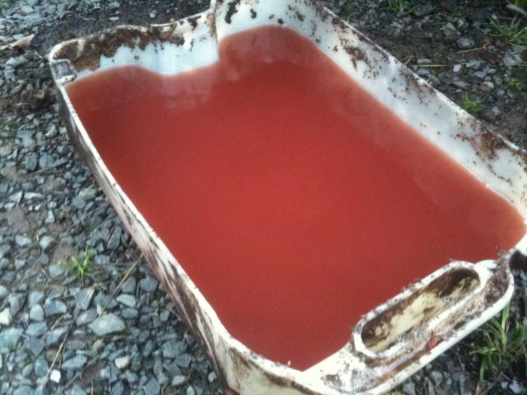

yeah i was wondering if its rust or just stains ?
- Posts: 5626
Re: The1's Daily
varnish
- Posts: 8114
Re: The1's Daily
if its dry, its silt/rust coming from the servo or processing plant. if its varnish it will be sticky like glue and stink like varnish.
in my experience all BP servos have brown/orange silt in the fuel.
I had several pumps fail. and I tried an experiment after cleaning out the tank and replacing the pump. I would only go to 1 servo and remove the tank after few months and get the same result. I repeated this on about 4 servos well apart from each other.
I get a tank full of red silt from each servo, I also separated the test from premium and regular. premium fared the worst.
All servos were BP. When I lived in Bendigo I used only the united servo up the road and when I replaced the pump then it was clean as a whistle inside.
So I conclude BP is shit.
BP fuel, on separate occasions. The shit thing is there are no other servos around other than BP, all which have the same dirty fuel.

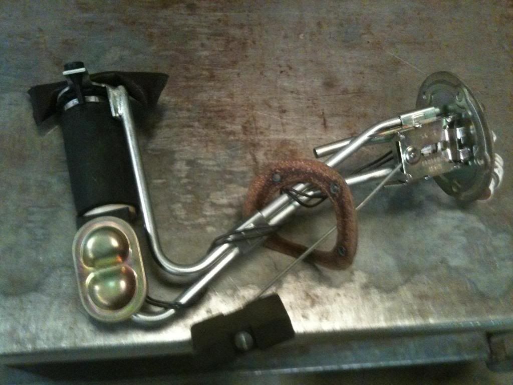

check out my vr fuel sender that used fuel from last decade. Almost like the NOS one I have. check valve and everything works. Tank in pristine inside.
Re: The1's Daily
man that thing looks like new
